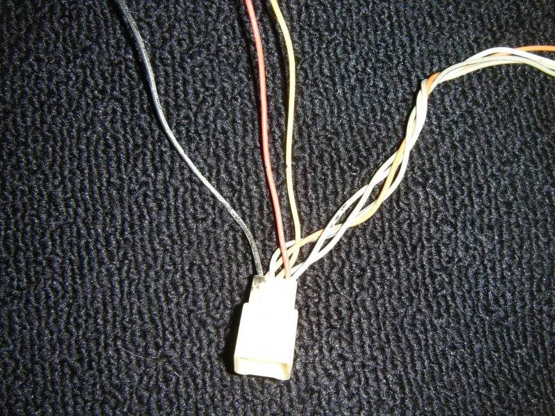

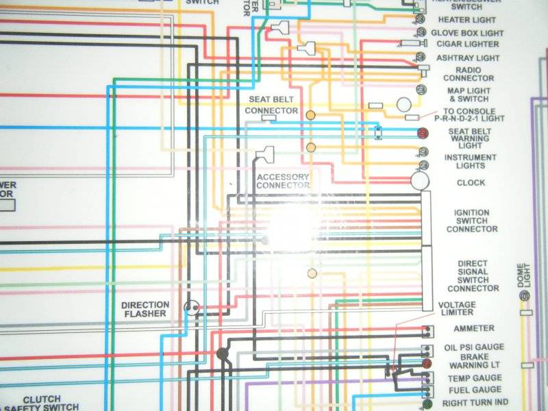

i have been wiring my new build 73 challenger got all to work but the turn signals. New 73 correct harness. The flashers work so the dash bulbs are in working order. What i am reading some trouble shooting talks the radio has something to do with the blinkers????? car had an aftermarket radio threw it away but still have the old wire harness. one picture is the 73-wire diagram other is old radio plug. wire diagram shows black wire goes to radio connect blue to tack red in from column. The directional blinker also has three wires blue black and red. Others say to wire together radio plug wires together to get signals to work others say radio has nothing to do with blinkers. I don't have turn signals but want to try all options before i get into steering column or other issues. new directional blinker also. any help or suggestions would be helpful thanks sjm
in addition, the wire harness from old radio has one black, red and yellow the other four are twisted together are the four speaker wires. sjm
