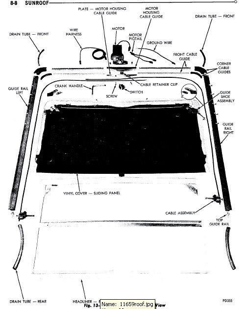

Took it out and wanting to re assemble. it was very hard to operate, but all parts ok..

looks great I guess, but 1973 chargers did not have power sun roof>ie crankers. But the same all and all.

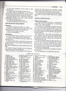

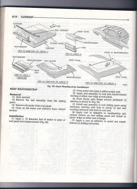

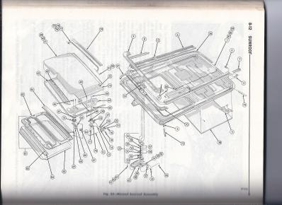

I'll fetch what I can from my uploads, but there's more posted by others-
Hmm, wonder why they're small.
Maybe when you download them you can enlarge them.
