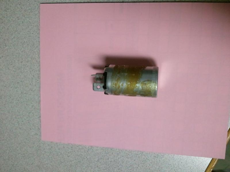

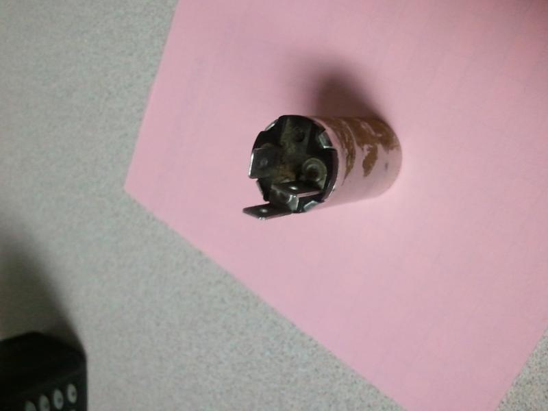

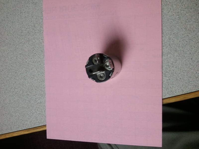

Ive been troubleshooting my turn signals and I found the flasher thats over by the radio, pulled it and took it to oreillys and they didnt have a replacement for it. Its a 3 blade but they are close together. Does anyone know where to find one of these? Or have a part number? I do have the 4 ways working, no dash lights, brakes, back up and markers all work. Any help would be greatly appreciated.
I took the old flasher apart and cleaned the contact points, they were nasty but it didnt fix it.
Rich
most,if not all,of our cars use the 552 two prong flashers.there is a 3 prong old school flasher but i cant remember the #.is there any #'s on the old can?

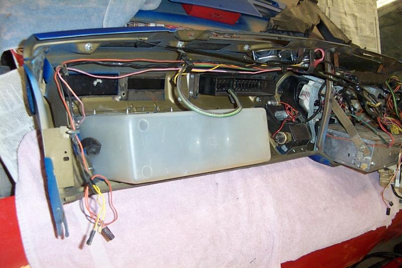

Nope. The turn signal flasher is on the side of the ash tray which I think you found?
Here is a pic. See it on the side of the ash tray housing next to the glove box? Little gold round thing with red wires going toi t.
Got it, it looks like the one i have pics of is up and to the right closer to the stereo. How big of a job is it to pull the dash?
Got them going! I had been searching on the driver side. So i got under the glove box area and there it was with no flasher in there at all. Plugged one in, checked it and they work! Thanks for all the info guys!
