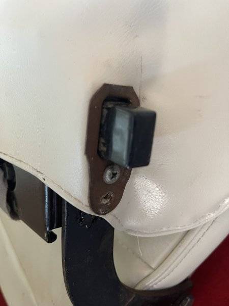

I need one of these metal retainers to hold my hinge button for driver bucket seat was missing it, does anyone have one for sale ?

I made one out of aluminum bar stock. It was thick enough that I didn't need the stamped guide portion.
I used the other side as a template.
Took about 45 minutes.
Works very well and you can't see it under the seat cover.
Might be a good plan B for you.
I was missing the button, too and found that bench seat buttons are the same, but the retainer is not.
