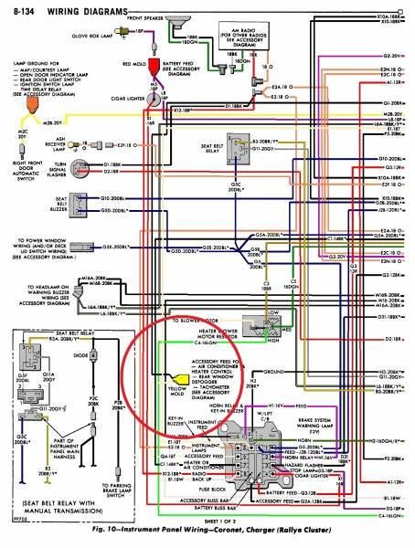

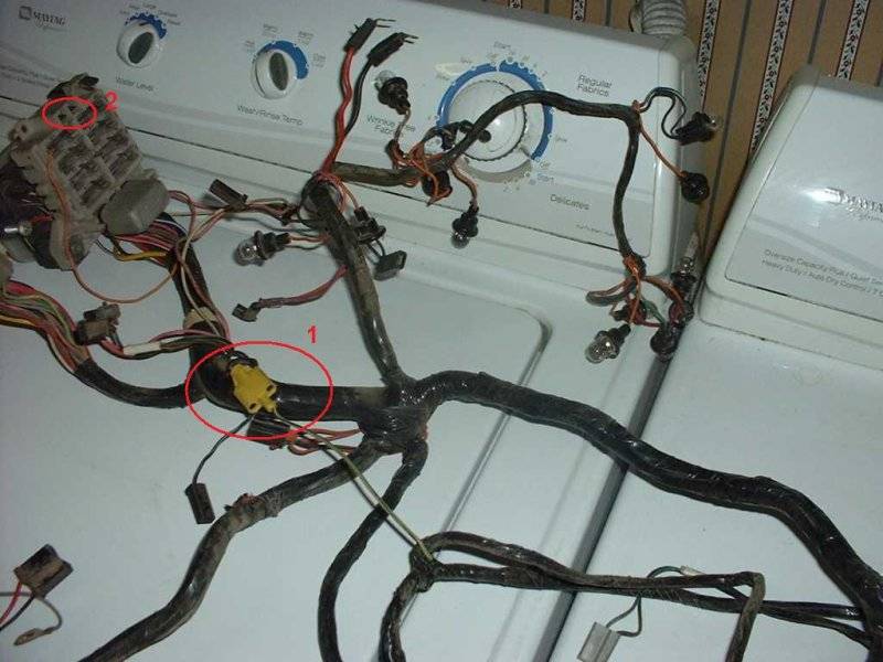

while I don't have my 74 FSM to check for the conection code ( it's 6500 miles from me, along with my Charger ) this is what the 73 diagram shows I have and is pretty much the same for all 71/74 for all the 71/74 accesories.
This is the mold to search for ( circled 1 )
I do have the 74 master diagram on my laptop, not the legend thought, and it shows, as you stated, the CI40 conector. WHICH if you search on the connections legend on the FSM, SHOULD show the same mold.
Diagram shows same accesories to the same CI40 conector, so even I don't have the legend with me, just the scanned master diagram I post, tracking the wiring on diagram takes to the conclusion, is the same mold shown above with same tan wire to feed that mold
