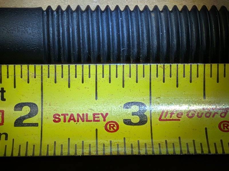

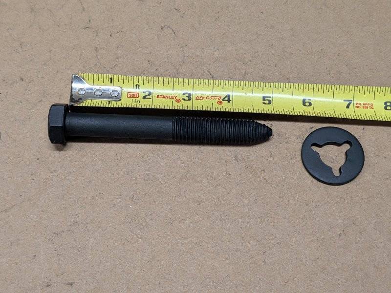

Can someone post the length and thread for the 1974 K member bolts? I need new ones and the generic 1962-1974 bolts offered for sale online look short to me. I am wondering if the 73-74 donut isolators required a longer bolt.
The bolts used to mount the K-member assembly with the original isolators are 5/8"-11 thread. The following images show an original bolt length and thread detail:
Awesome. Thanks so much. That's exactly what I needed. Now I need to find some for sale.
