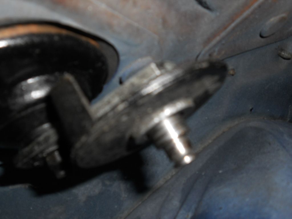

I recently bought the car and found all of the wiper linkage in the trunk and, obviously missing hardware. I picked up 2 different types of clips to attach, but it seems that there may be a special spacer (and washer?) that I need. Below is a pic of the issue that I have as well as the parts that I have. Can someone steer me toward what I need and where to get it? Thanks in advance!
Looks like you are missing the wiper motor crank cam internal parts, plus the rubber cover. Don't have an exploded view or a good pic of what it should look like either. Hopefully someone will post up if they have one.
Not sure if they are still available, but I do have a NOS Release pkg PN 3879325 that I bought years ago when my old 74 RR had an issue. My Brother worked for a dealer in the Parts dept and told me to buy two since they were limited.
This kit, plus I have several small rubber bits that I think go on the end of the arms. http://www.bradsnosmopar.com/nosmop70wwip.html
If you can't find one, PM me.
