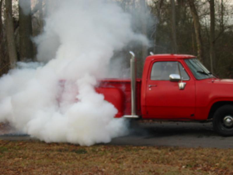

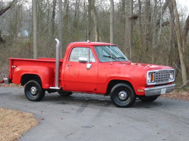

If you do the truck, keep it a simple low budget build. You won't get your money out of it later. Put a good used 360 and 727 in it, and have some fun. Build your bankroll for your dream car. I owned this LRE and drove it beater style for 7 years. Looked into restoring it and found out when done it wouldn't be worth what the drivetrain and paint alone was gonna cost......
ha-ha! a Tennessee Tire Warmer!! love it!!
Haha but I'm betting the tire warmer is used in VA and I wonder if some of my family helped invent it haha they are from WVA. <---laughing hard now just thinking of some of their ideas for things.

Great looking Little Red Express. I always loved those trucks and in my area I have only seen one and it was at a car show. I always wondered where that one went to. I also saw a few years ago a Yenko Nova at a local glass shop and I have not seen that car since. I do know there is a Yenko Camaro in my area. The Little Red Express trucks always had that cool look to them and its one you just got to look at when they pull into a show.
