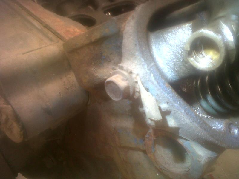

I do not have the 318 pulled yet, but I believe that the oil burning that I was experiencing was due to an error on my part.
When I put the LD4B intake on the 318, I was in a hurry, it was weeks away from my wedding in 2011, and I was all preoccupied.
I forgot to check dowel pin to intake clearance and the intake was not fully seating on the heads, thankfully, the intake did not suffer any cracks.
The 318 will still get a closer inspection after getting pulled, and it will get used in another car one day.

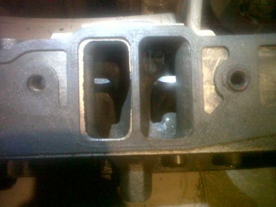

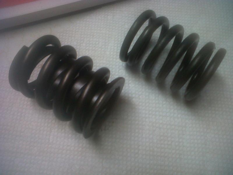

I am porting the J heads that came on the 360, and installing 340 valvesprings to work with the .441"/.441" 276/286 114lsa cam that is in the 318.

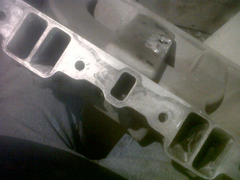

IMG01868-20150305-1641 - Copy.jpgIMG01870-20150305-1645 - Copy.jpgIMG01871-20150305-1646.jpgIMG01876-20150305-1730 - Copy.jpg

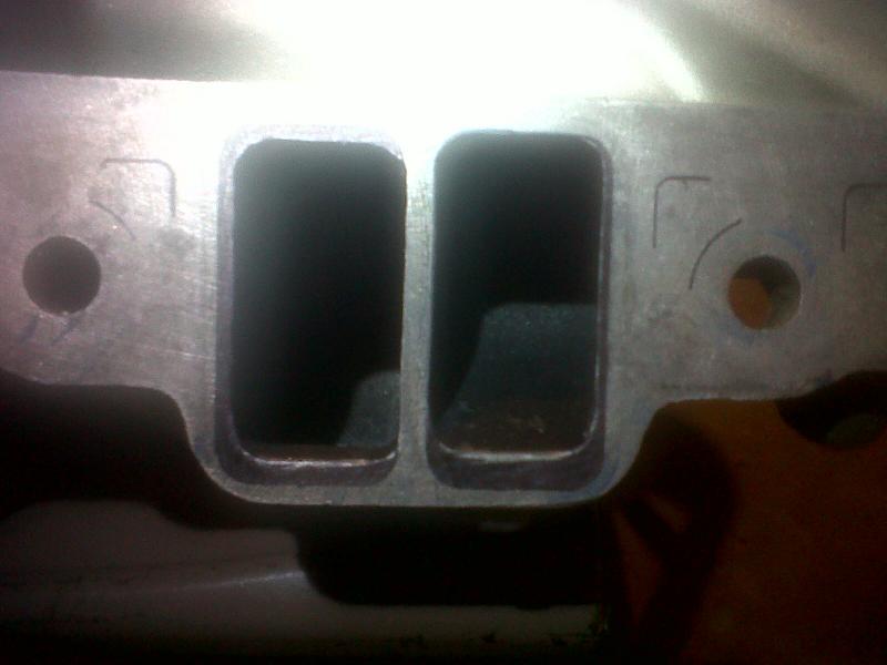

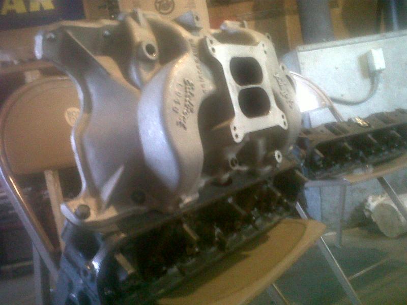

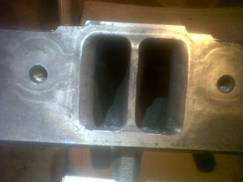

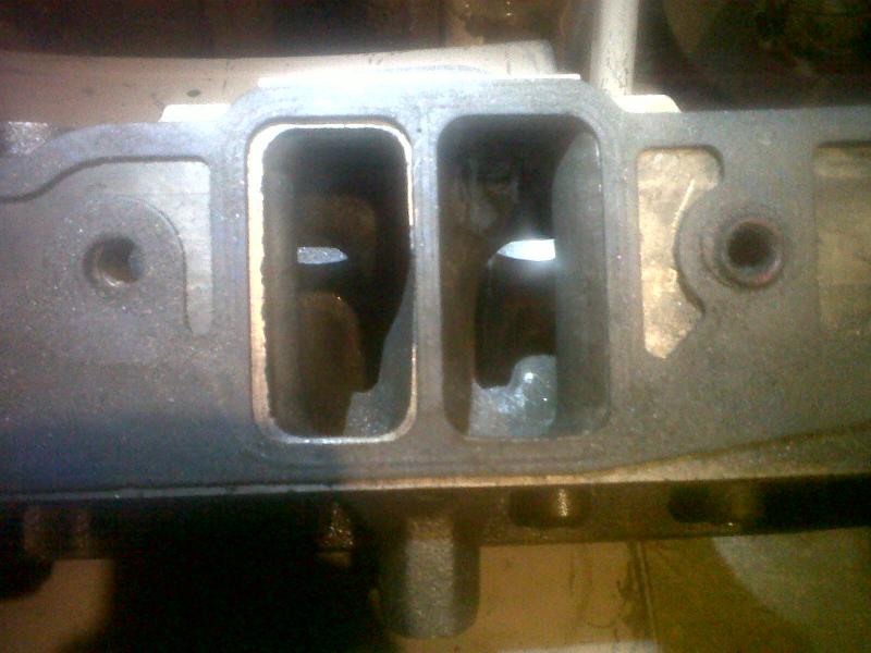

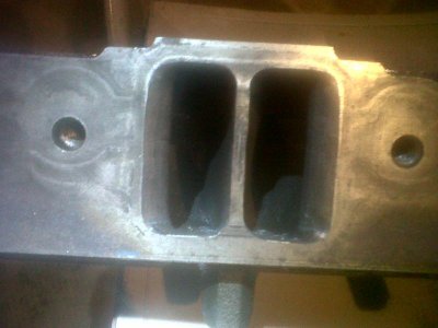

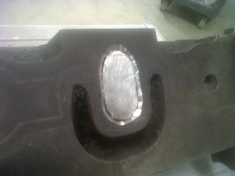

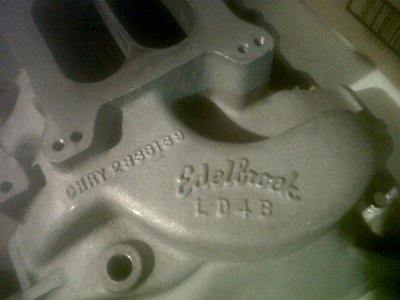

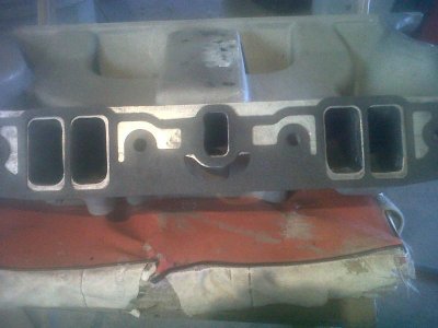

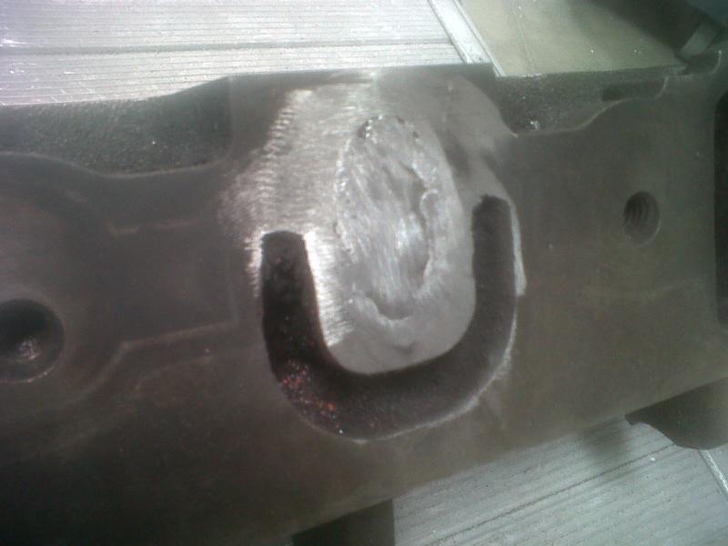

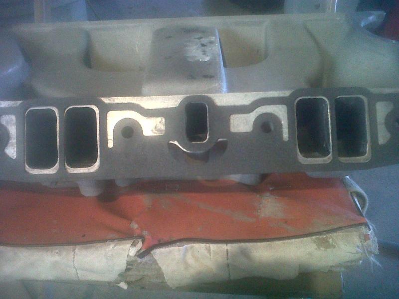

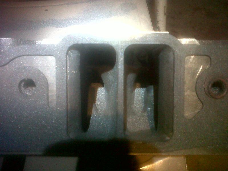

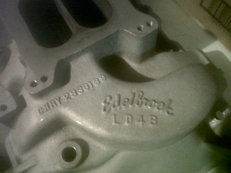

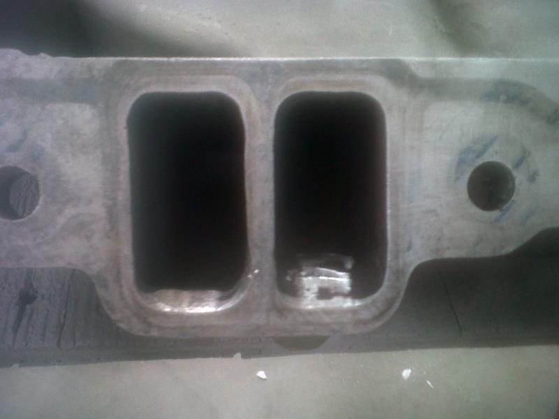

Here you can see the core shift issues in the Edelbrock LD4B. This gave me no guilt in opening up the ports to 340/360 size.

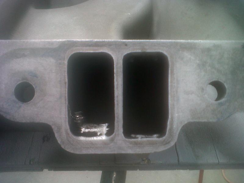

IMG01891-20150312-1326.jpgIMG01892-20150312-1327.jpgIMG01914-20150329-1600.jpgIMG01916-20150329-1658.jpgIMG01917-20150329-2252.jpgIMG01919-20150401-2209.jpgIMG01920-20150401-2209.jpgIMG01921-20150401-2211.jpg

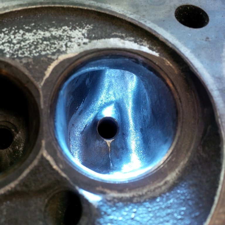

I opened up the intake ports just over 1/8" wider top to bottom at the pushrod pinch, opened to port window to match my Fel-pro gaskets. Also working on the bowls, it will be fun to see how my budget 360 performs in the Cordoba, more updates to come throughout April, stay tuned.

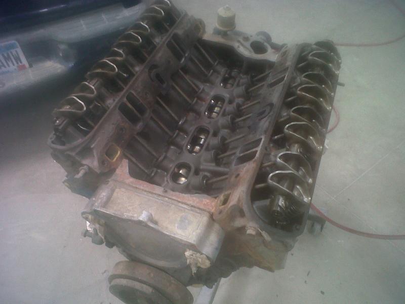

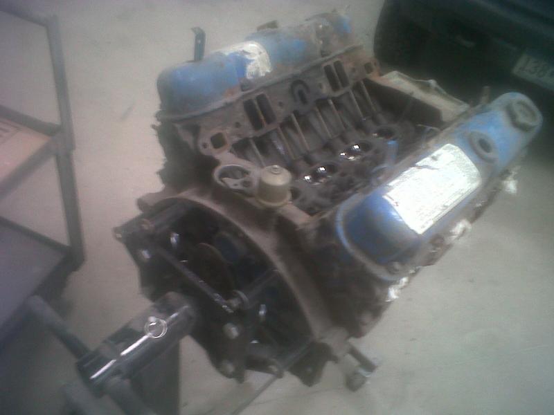

Starting tonight, I am going to get working unbolting everything and plan on pulling the 318 either Thursday or Friday night.

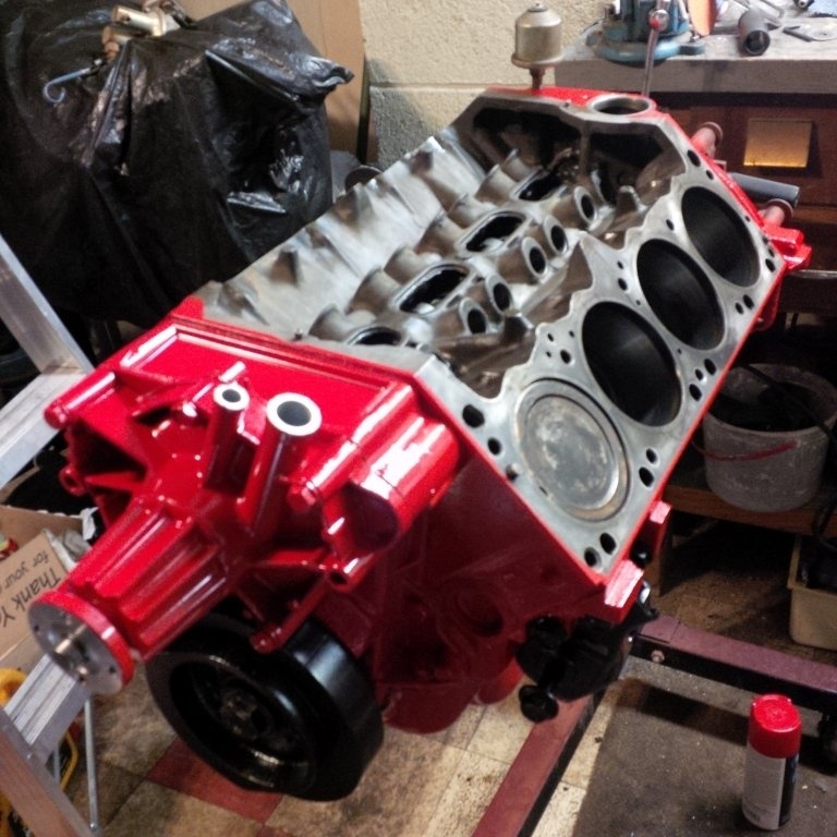

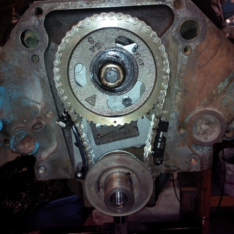

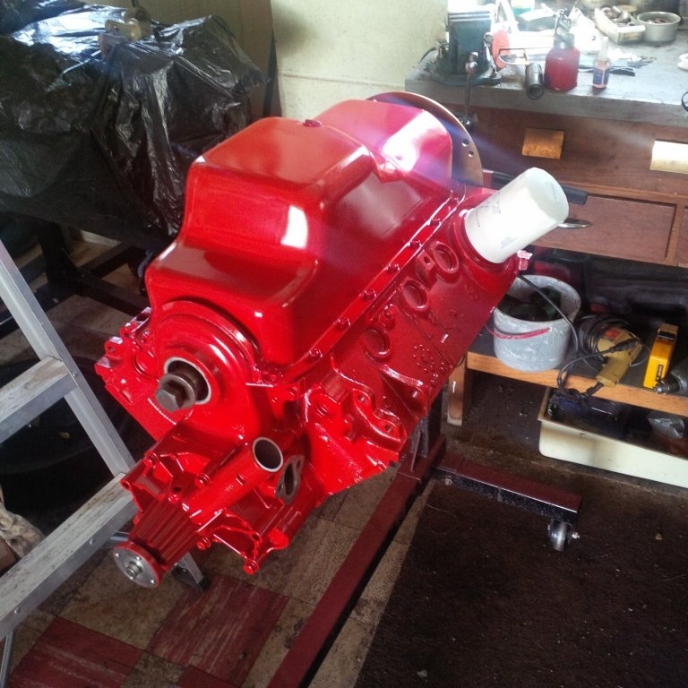

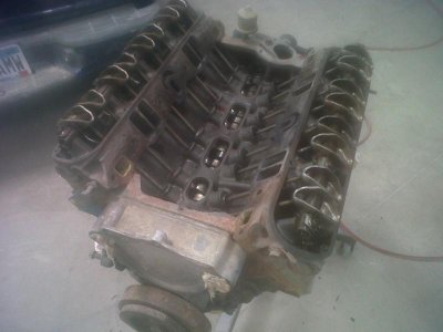

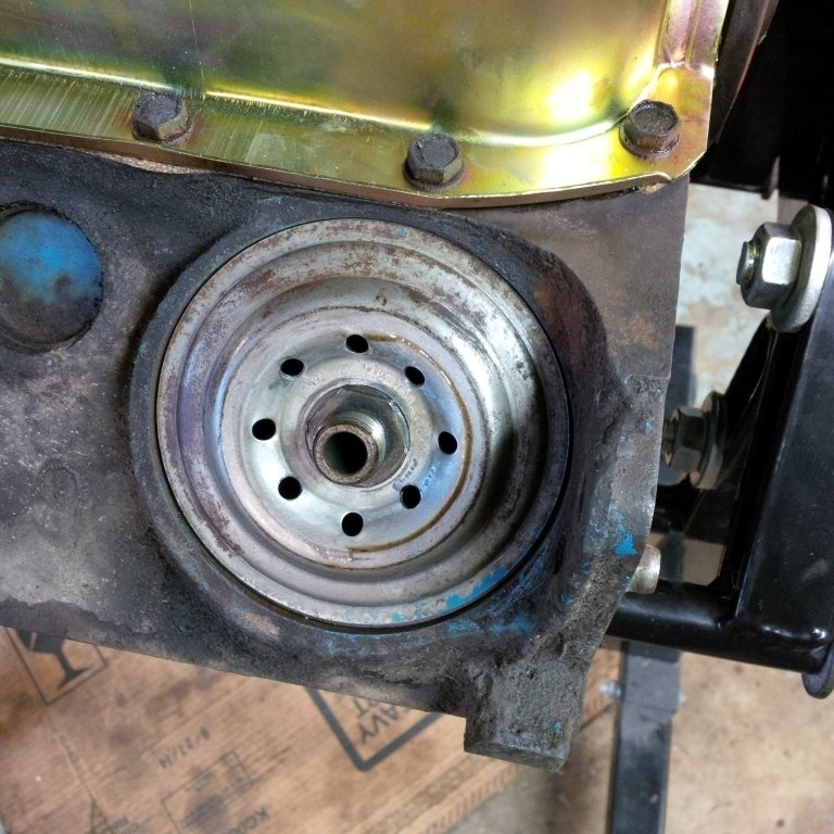

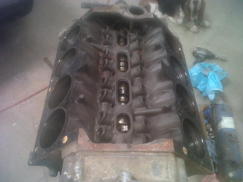

Got the 360 shortblock all ready to go with a new oil pump, swap meet windage tray, new cam, timing set/tensioner setup, water pump, and all new gaskets. Would have had the heads done by now but had some bumps in the road since last year. My dad had to have open heart surgery for an aortic dissection, thankful he is still here, been in the hospital since May 1st. Hopefully he will be home soon. Here are so pics of the Doba's 360.
