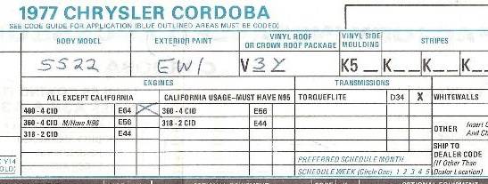

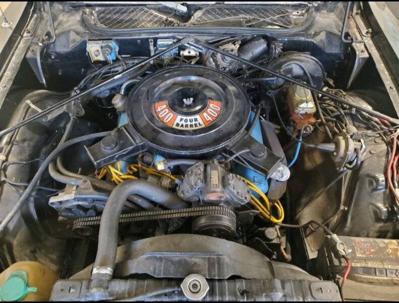

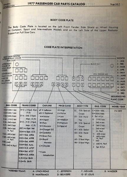

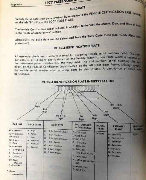

A person can order two 400 v8 engines in 77. But the N code is on both cars. Your fender tag will show if the higher horse power engine was ordered.The same with the 9 1/4 rear. It was a 3:21 limited slip option, and the transmission then was non lockup 727 HP. if the tow package was ordered, then these options became standard,as well as heavy duty brakes.

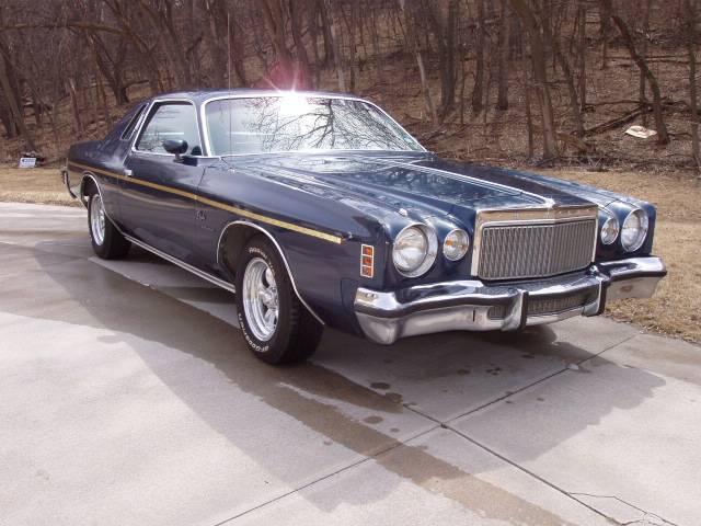

my Cordoba was ordered this way, as well as 100 amp alternator, P.S oil cooler, and transmission oil cooler, no vinyl top.
OOPs, I stand corrected, the HP 400 was a P designation.
