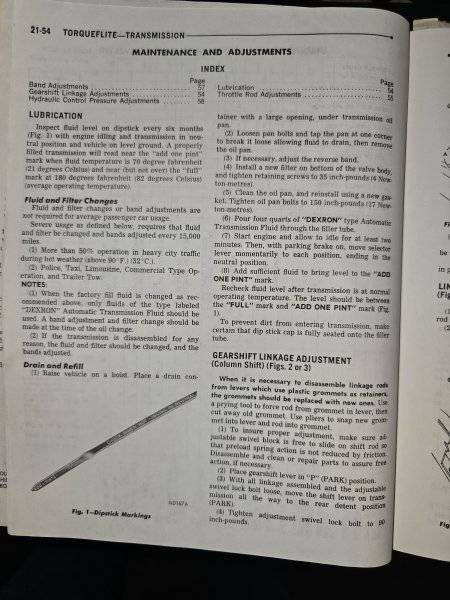

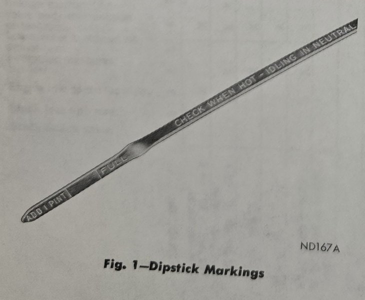

Low level on trans fluid? You won't believe how many people don't properly check the fluid level. The following comes from the 1979 Factory Service Manual:
(7) Start engine and allow to idle for at least two minutes. Then, with parking brake on, move selector lever momentarily to each position, ending in the neutral position.
(8) Add sufficient fluid to bring level to the "ADD ONE PINT" mark.
Recheck fluid level after transmission is at normal operating temperature. The level should be between the "FULL" mark and "ADD ONE PINT" mark (Fig. 1).
View attachment 1851211View attachment 1851212View attachment 1851213
I'll reply to a number of questions or suggestions. First thing I did was check the tranny fluid. It was full. During the test drive, i did manually shift. It went thru all three gears, still with the slippage. Documents indicate the rear axle to be a 3.2, with posi. Under power brake, still did not notice reaction until estimated 1800 RPM (no tach in car). I still thinking that the builder put a high stall converter in.
