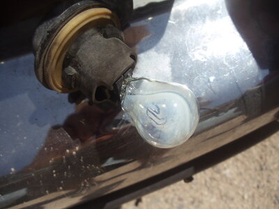

Changed the bulb but the parking light still did not work. Tried the turn signal, which worked, but the new "Valucraft" 3157 bulb spewed out a milky white liquid inside the bulb (see first photo). I wonder what that is?

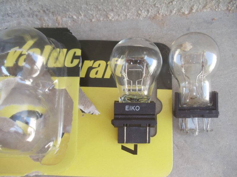

The old bulb that I removed has a glass base and the filaments don't appear to be burned through/burned out. The new "Valuecraft" bulbs have a plastic base (see second photo).

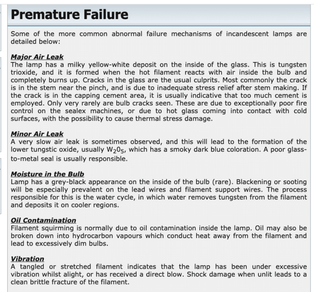

That white milky stuff was a burned out filament.
Remember what flash bulbs looked like after use?
