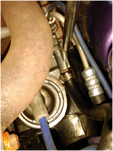

It's not actually at the worm gear nut.....it's leaking all around the vertical section of the gear box guts (wish I knew the name)....cross shaft sector gear maybe? It's about 4" wide & circular. It has what I call the "worm gear" screw/locking nut in the middle of it that you're talking about..... wish it was just that.

Hey Beater, it DOES seem like a pressure issue....these are not "leaking" gear boxes....they flow like a RIVER (full quart p/s fluid drains out in 60 seconds on both gear boxes & from 2 different locations of the gear box(s).
So please explain more. In your picture, the right half with the hose barb type nipple I bought off ebay & have used it on BOTH gear boxes. Is that my problem? The left half of the part in the picture with the threaded flared fitting was included with both p/s boxes (2 different ones obviously), BUT that nipple part where the p/s return hose is attached has been the same.
First, how do I know that my "right nipple half" is centered & working??? I thought the pressure relief valve was in the back of the p/s pump where there pressure hose attaches, but I have no clue honestly.
I'm not sure why it matters, but everything with the p/s pump bracket seems OK. I did have to use a few washers to center the p/s pump pulley with the crank pulley. Since my car was originally manual steering, I don't have another p/s to compare with.

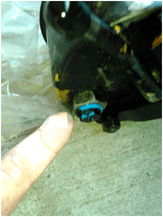

I was thinking the pump too. I'm almost done putting the first p/s pump back on the car. I figured I have nothing to loose. HOPEFULLY the leak is actually at the return hose & not the gear box itself.....I did put another clamp on that hose to seal it....but just hoping. I guess the p/s pressure hose could be bad, but HOW? I mean those fittings are bone dry.
Here's the first pump that was on there...the one I'm putting back on.
The 2nd pump (when the leaking started) bolted up the same, but has a plastic reservoir. I just took this one off.

FIXED IT! Thanks everyone for your help & especially beater who talked me off the ledge.
Here's what happened.
1. First gear box was "borderline" and wearing out.... but I thought it was the p/s pump.
2. Replaced p/s pump.
3. 2nd p/s pump's pressure valve was set too high & that killed the 1st gear box quick.
4. Still with the 2nd p/s pump, I had forgot one of the two O-rings on the p/s return line fitting. This likely saved the 2nd box. The leak I "thought" I was seeing on the sector gear (?) around the worm gear was actually that missing o-ring (right above it).
5. I put the first p/s pump back on & replaced a 25-cent o-ring....FIXED!
