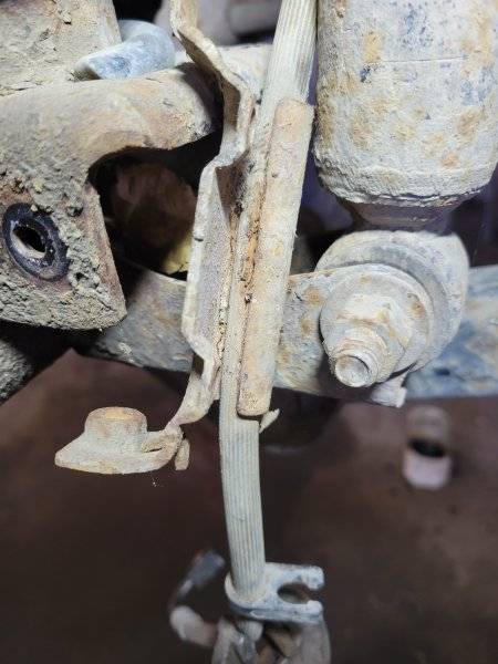

I'm not expecting an answer, just passing this problem on. I have owned this truck for fifteen years, and the "anti-lockup" brakes have never worked. All was well with the brakes after over a hundred K, until last week, the left front pads were worn down and destroyed the rotor. I was surprised as the pads were replaced a year ago. All was good after the garage repaired the damage. I drove a hundred miles, and the right started making the same noise. I had driven fifty miles from home on I-75 into Detroit, and the brakes were fading. As I got off the E-way the noise was worse. I'm thinking the anti-skid had energized the calipers on its own. All I can see is a grand or more in repairs here.
I'm considering replacing the system with a non-anti-skid system. Note: Several weeks ago, the brake pedal went to the floor one time in traffic. Luckily, I was able to drive off the road, and there was no accident. Since then, the system has worked as always. But I did replace the master cylinder just in case.
This happened on one of my Dodges a few years ago. Turned out it was the rubber hose as it collapsed on the inside. I realized it when I could not compress the caliper..
This^^ but from what I've seen several times it's the metal clamp that holds it to the control arm,, forms rust inside and pinches the hose. Pry open the clamp, and fluid flow is restored. Should be replaced.

Thanks for your input, but do both hoses do it at the same time? I will look into it before proceeding. Thanks

They can if they are the same age…
I do know the whole hydraulic system bled normally, if that's any indication of anything.
If the bleeders are pissing out freely and the same sided to side, there's not likely a flow issue. Have you ever tried locking them up at speed on gravel?

They can bleed normally but still have issues with locking up. The hose can break down internally and only allow flow one direction, essentially letting you brake but never allowing them to release. I've also seen this happen when a brake pedal doesn't return fully, as it holds the master cylinder spool forward slightly and prevents fluid from returning.

Hoses are the first try to fix. My 98 3500 did similar thing just a year ago. I also did reseal the calipers at the same time. Very easy job I was surprised how much gunk was in them.

Both hoses are on the way.

Just happened to have a 14 jeep in with the clamped line problem. I opened it up, fluid poured out. New hoses coming. But appears that the OPs hoses don't have that..
