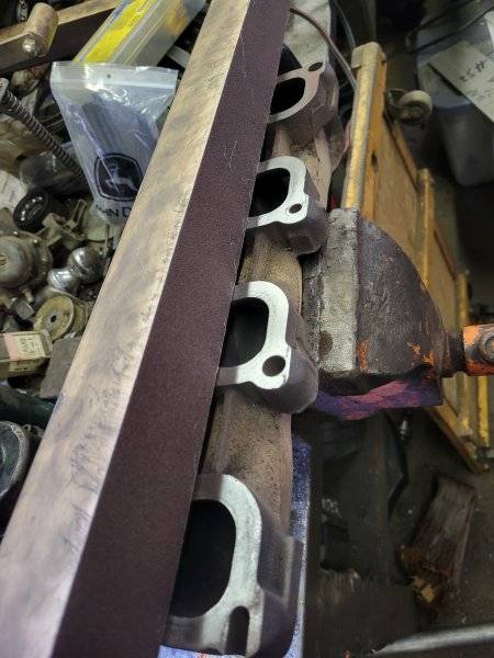

That manifold may have been machined in the distant past to match a set of heads that were shaved - which means that any new heads will never match the manifold.No time for me to back read. Have the heads ever been planed? (machined) If so, depending on how much they milled off, the intake surfaces will not match the intake surface angles.
I know this from experience.
