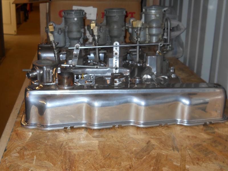

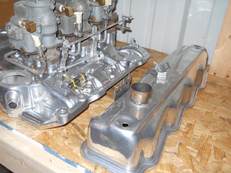

does anyone have a picture of the top of the block where the valley pan goes? I want to put 315 hemi heads on my 318 polysphere and I think without much work it can be done. I would like to know if there is a lip on the block to mount the pan. I have herd they may have changed the casting some. any info or pictures will help. thanks 001.jpg006.jpg004.jpg the edelbrock p 600 manifold and carbs. were a swap meet find and will fit the poly or the hemi.
This is a poly manifold, will not fit any hemi block that i know of. The hemi heads will not fit the plymouth dodge 318 poly engine they will fit the desoto chrysler poly head engines.
