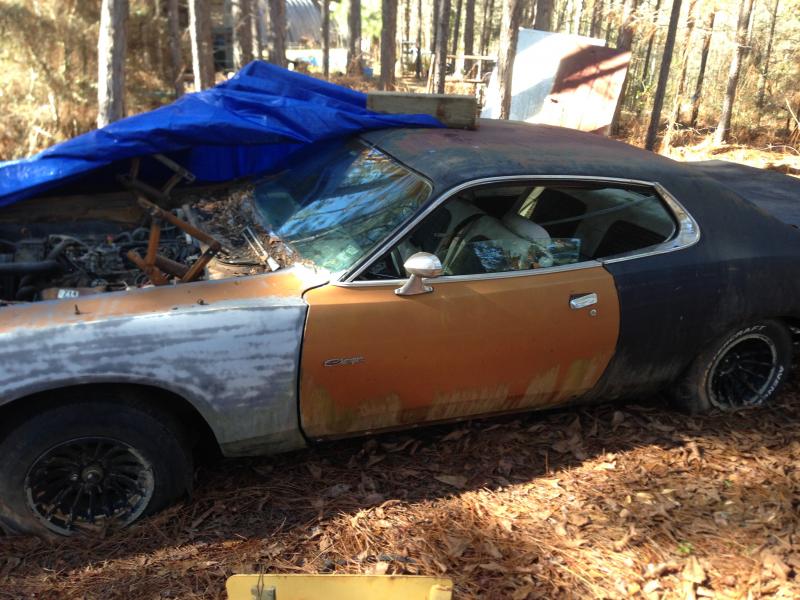

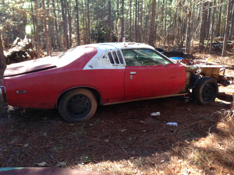

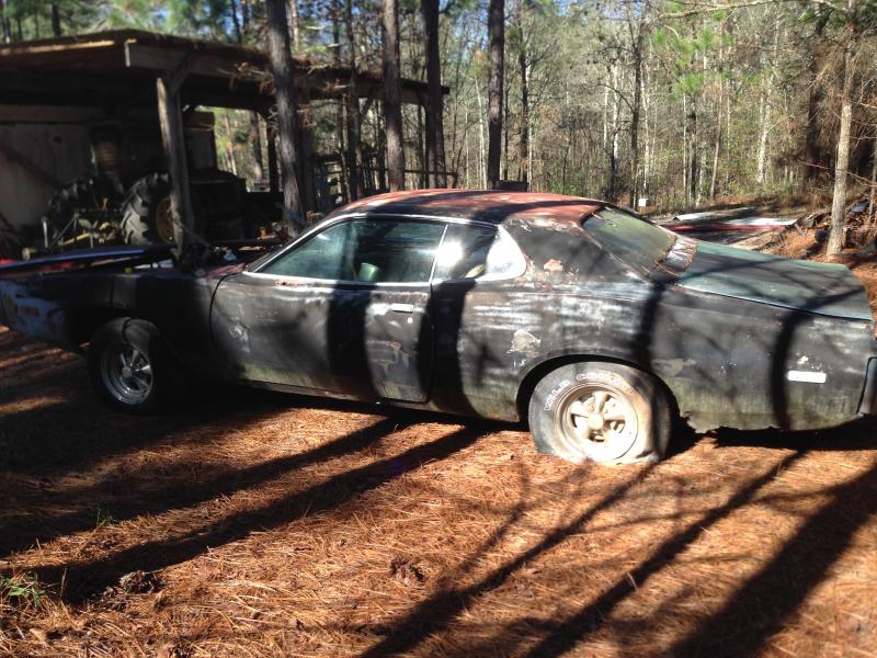

I'm trying to get this one running and roadworthy again first using panels off of the other cars. I'm working on rewiring it now. IMG_0034[1].jpgIMG_0035[1].jpgthe one below has no engine or transmission so im using it for parts at the moment.

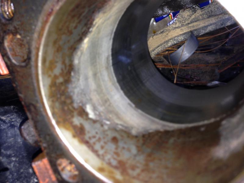

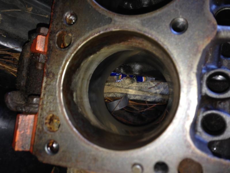

IMG_0036[1].jpgThis is the cylinder thats rusted on the engine I pulled. I'm hoping its not pitted too bad so i can use the block without going too far over. its already .040 overIMG_0037[1].jpgIMG_0038[1].jpg
