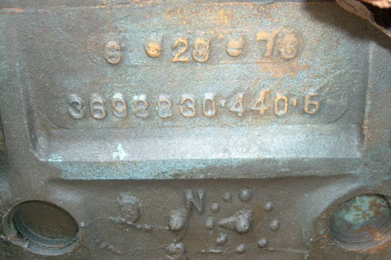

In a 66 it should be a poly.
Is it?
Should be a casting date on the side of the block that tells you month/day/year on the side.
a-guide-to-mopar-v8-cylinder-head-and-block-casting-numbers-2018-07-30_20-37-49_539308.jpg
