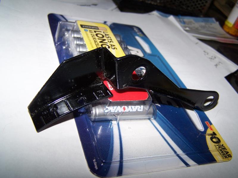

The 66 Belvedere ll I got recently was missing the timing tab on the engine.Someone give me a timing tab and im not sure if its the right one.It has the 318 Poly engine in it and it doesn't have the timing marks cast into the timing cover like the LA engines.The timing tab I was given appears that when bolted up the timing mark should show up on the passenger side of the engine,yet when I put a timing light on it the mark on the balancer is coming up toward the driver side.I don't know if I have the right timing tab and it has the wrong balancer or whats going on with it.Can any of you that has one of these engines post up some pictures of the timing tab and the balancer area?? Or have any insight on this?:confused2:

This is the timing tab I was given.The two bolt holes seem to line up with the two bottom water pump bolts.
I say again, the least expensive thing is to mark the balancer with the new timing tab, and call it a day. As long as it works fine, who care where the cut mark is. I use a white paint pen to mark the balancers. I could check tomorrow, but even if Power Bond did make one, it would be expensive as they are not that popular. There is a place in CA called The Damper Doctor ((530) 246-2984) that can rebuild yours with the correct marks, or they have one on the shelf. It is the same here too, and an unpopular 318 poly might run at least $150 or more.
Remark yours and be done with it... :glasses2:
