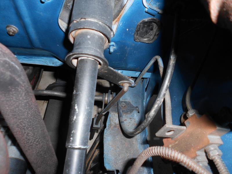

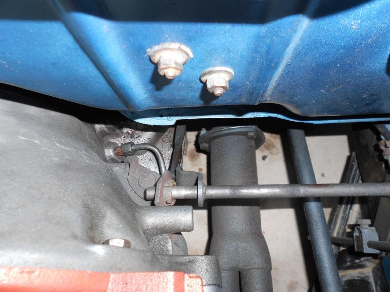

This started out to be a temporary fix until I could find offset rod, but its been there about two years now and seems to be working fine. I modified brackets to go on top of frame instead of side. This is a 71, small block with 904.
Sometimes i think headers are the worse thing on these cars, getting in the way with things, my SB headers arent bad but ive seen enough BB applications with the headers giving starter problems as well as this.. good luck, maybe the company's making headers will come up with a set some day to solve these problems..
I just installed a set of Hooker super comps on a 72 with a 383.... Their instructions outlined flipping the brackets like this
