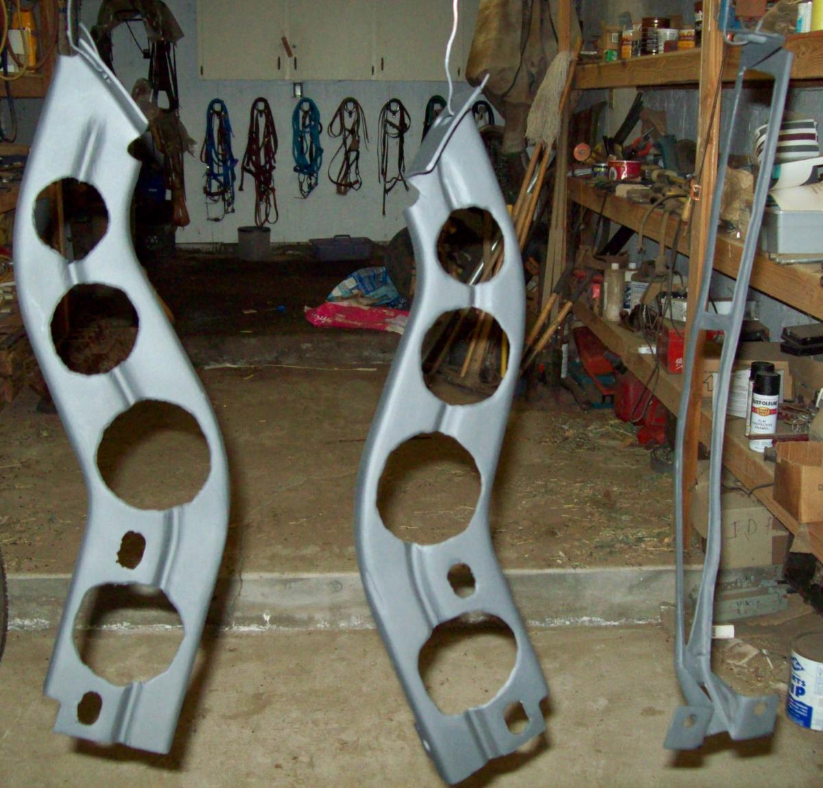

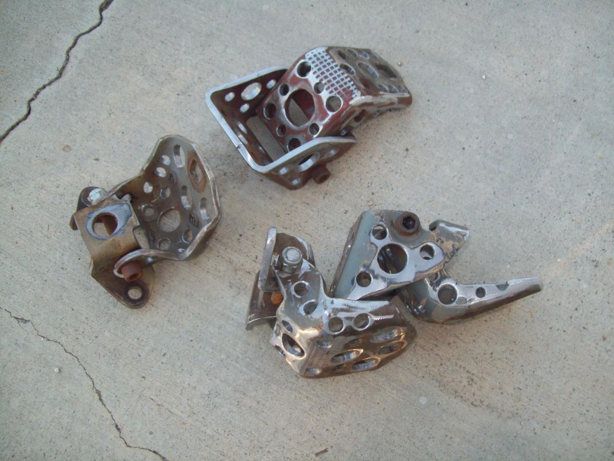

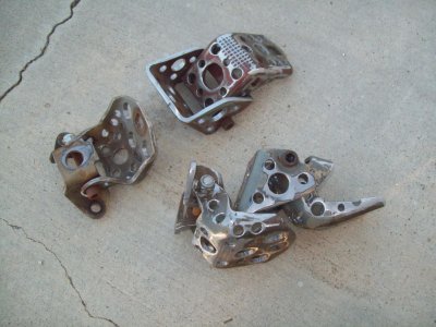

I put my 66 Belvedere on a diet when I got it....went from 3370 down to 2950 and didn't touch the engine or air conditioning. Got rid of the undercoating, put on a glass hood and took off the front bumper ala 55 Chevy style lol. Rear window cranks and gear went too....

I see I'm not the only one that drills holes everywhere lol. I also use a Greenlee knockout punch set for anywhere that's hidden behind door panels etc. I also use aluminum back plates for the door hinges....
LOL! Ya I am a little nuts. Would not do that to a street car. This is for a drag only car with lexan windows.
Thats a good idea! Thanks for the tip. HMMM where did I put that scrap aluminum?
