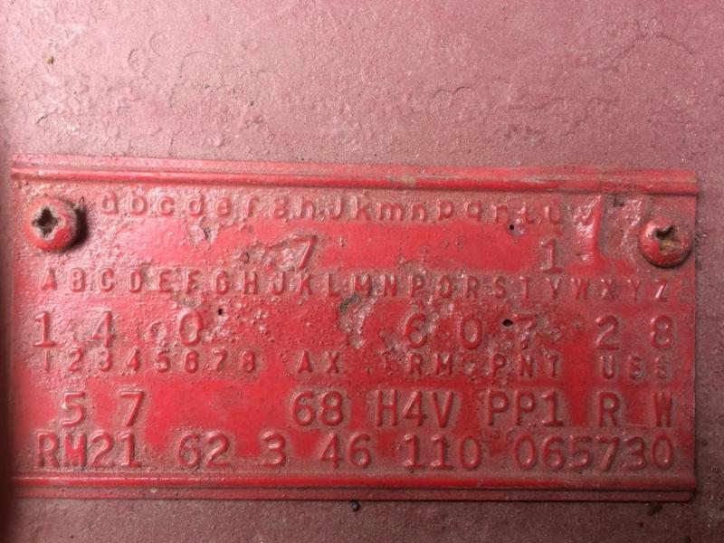

Hello, I have a 1968 January production 383 Roadrunner, original 4 speed according to fender tag. I'm still a bit confused as I've read some eng/trans combos match a shipping number on fender tag and some don't in '68, is there any confirmation of this without having a built sheet?

The fender tag is as shown, is there any way to figure out whether the set-up is original.. I have no build sheet
The fender tag indicates the car came with a four speed.
Is your VIN RM21H8A143712? (The fender tag appears to be from a car built at the St. Louis plant RM21H8G)
If yes, then the engine and transmission came with the car.
If that is not your VIN, then the two came from another car.

VINs on '68s are a controversial and under researched subject.
Yes, some '68 engines and transmissions have VINs and some do not. Some contented that only the 383 and 440 HP cars got VINs.
(anyone have a /6, 318 or 383-2bbl with a VIN stamped on it?)
It does appear that the different plants may have stamped VINs at different times. The STL plant did start early in the year.
It appears this drive train is from an Oct/Nov built car at the Lynch Road plant.
Was your car built at the STL plant? RM21H8G******?
Yes my car was STL built RM21H8G. Built January 10th 1968. Engine and trans around early October of '67 and they match each other.
