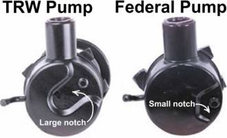

Hi Dave - That's really useful.
I didn't know there were 2 types of pump.
Think my current pump is the Federal type but as it's fried I'll be replacing it with the correct one for the brackets (if I can find one)! Hope Rock Auto can help.
Back to my original question - will the brackets from the 440 bolt up to my 383, or did they have different brackeys for the 2 big blocks?
Thanks for the info - appreciated!
Limey
Brackets do interchange between all big blocks. As others have said, make sure you have the proper ones for your particular pump. Also, size of return line to pump changed from large to small sometime around 1966, so you have to watch what size line is on your steering box.
