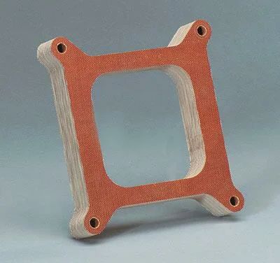

i,ve insolated fuel line with tin foil and put a cool carb poly gasket ...
