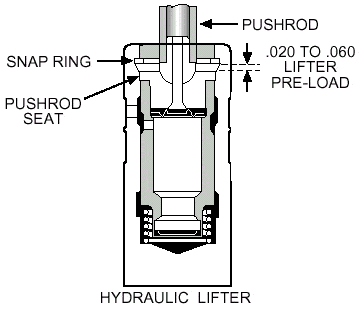

Use cylinder #1, for example, at TDC compression stroke. That would put both #1 tappets on the base circle of the cam. There should NOT be any up and down play for the two pushrods. You should be able to easily spin the pushrods, that show there's no excessive pressure. Of course, you've got to remember tappets work off of oil pressure, but even without, there should not be play at the pushrods.
Can't find it right now, but...correctly set up, when the tappet is sitting on the cam's base circle, the plunger in the tappet should be pushed down, via the pushrod, a minimum of .010"...max .050. That measurement is from the top of the plunger to the retainer clip, or wire.
That makes a zero 'lash' at the rocker arms...no up and down play.
If you do have play, 'something' is wrong.
Here's a one size fits all for hydraulic tappets.
This one shows .020 to .060.
