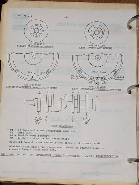

I have only had 440s or a Hemi all with Steel crankshafts. What did the 383s come with for a crankshaft?
I think everything through 1970 was forged steel. I’m not sure about the years that followed.
The 383 engine used a forged steel crankshaft in all applications until 1970. The cast iron crankshaft was introduced in the 383 in 1970 and continued in 1971 in some two barrel applications.
The following two images show the Technical Service Bulletin (TSB) describing the change:
Considering the number of years 383's were made, and the sheer number produced (the most popular big block by far, IIRC), that makes the cast crank version a big minority. Forged 383 cranks should be pretty easy to find.
