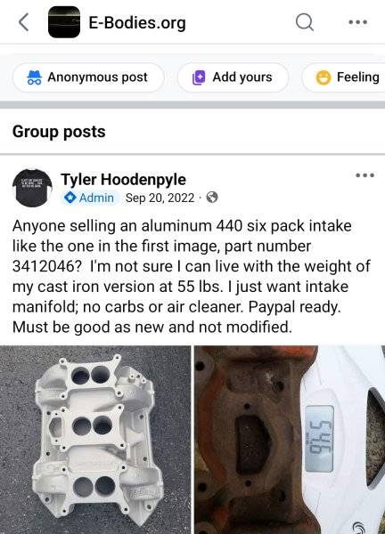

Found a picture of a 440 3x2 cast iron manifold on the scales.
It shows 54.6 lbs
Cast number 2946276 for cast iron.
Source:
Tyler Hoodenpyle at E-Bodies.org

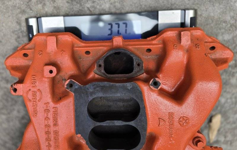

Also, the aluminum Edelbrock DP6B for the B engines is more than 17 lbs lighter than the cast iron 2951666 used on my 1970 383 HP.
37.7 lbs cast iron (with 2 light coats of paint)
20.4 lbs cast aluminum (bare)
________
17.3 lbs
____________________________________________
The second digit looks like an '8', not a '9', but casting number 2851666 does not show up as an intake manifold in a Google search. Intake casting number 2951666 shows up all over the www.
Note: The black is not carbon. It is a proprietary rust converter I used back in the 1980's.
