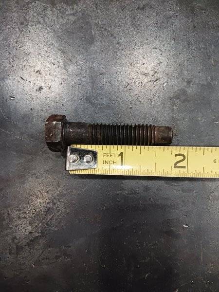

On most, valve covers are 1/4-20 x 1/2 with factory covers, and 1/4-20x 3/4 with cast aluminum covers. Make sure the holes aren’t full of RTV. Intakes are 3/8-16 x probably 1 1/4- 1 1/2. Use t-tape, or pipe dope to prevent oil wicking. This can vary depending on washers, hold downs, etc.
Here's a factory intake bolt from a 1973 400 with a 2 barrel cast iron intake.
