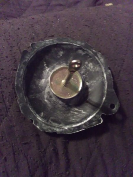

I thought the three barrel vacuum pod used the same size diaphragm as a Sixpack two barrel. Am I wrong?
According to the information contained in the YouTube video above the vacuum diaphragms are not the same as the ones used in 6-pack carbs.

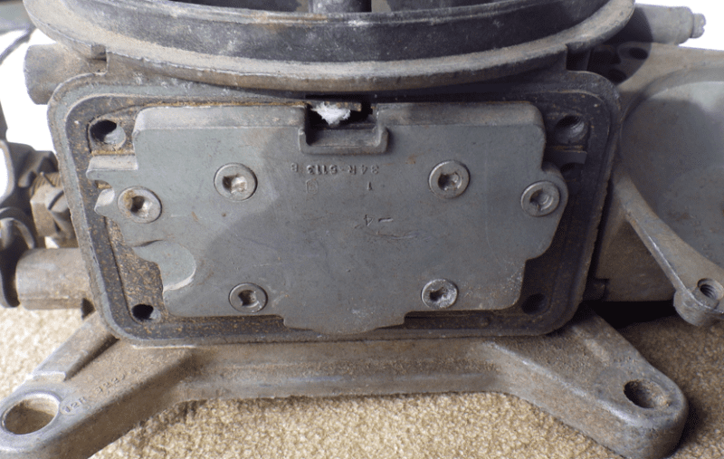

hi Tom. . ya this is a 950 and someone at some point put a rear block on it. im going to go stock with it and see what happens. then go from there.
Was that a "new" part, or new OLD stock?
new. it seems that thay make a few from time to time. kinda have to catch them when thay feel like doing it.
the white powder on it is from when thay make them. wipes right off.
The white powder stuff is called bloom, anyone in the rubber industry knows that. I once looked at a 66 Belvedere 426 Hemi, with only 29 miles on it. It still had that white bloom on the door and trunk seals. The first time I had ever seen that on an old car.
o boy .... now i have all the missing parts to finish this thing... happy dance:bananadance:
to bad she put the flouts in the wrong spot..... brass needs to go in the back.
My new brawler has the brass float in the front, the plastic float in the rear, because of the cutouts for jet extensions. I think that is common nowadays.
Edit: I guess it won't matter on a 3bbl. No jets on the rear, metering
plate only, right?
