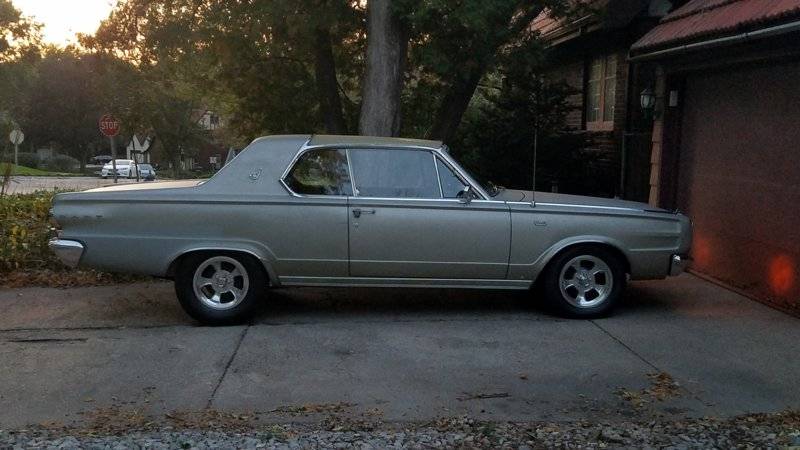

I run 4.5's on the front of my Dart. They have 165-80/15's on it. I drive it easy on the curves although it shouldn't be a issue.

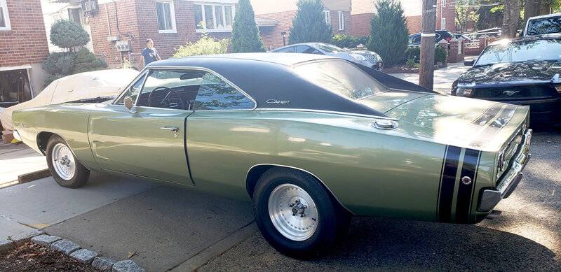

Looks great...we run 4.5's on street since the 70's..they're great for going in a straight 1320 line on the strip or street.

You will have no problems I have been rocking drag radials with a stick shift and 3.5" front wheels on the street for almost 20 years. Never an issue as long as you have reasonable expectations. 1 mile gravel driveway fwiw
