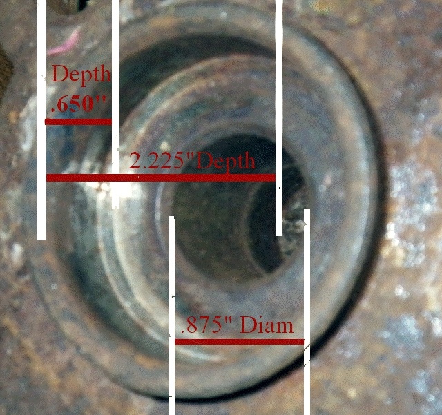

Some depths I measured on a 440 crank (diameter is incorrect)......
Should have an 11in clutch, 143 tooth flywheel I believe as stock.
Use a stock pilot bushing to see if it was reamed from factory, and is deep enough. Measure it, somebody on here will chime in those dimensions I'm sure. If deep enough, but not reamed to final size, there used to be a undersized bushing. They are very hard to come by, but somebody up in the Midwest was making them. I may know someone.....ahem that has a stash if you can't locate one.
