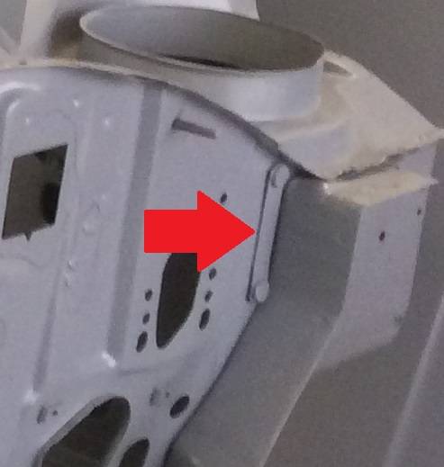

Putting a 4 speed in an auto Charger. Anyone have a pic or information where that 4 speed firewall stiffener brkt goes? Thanks
Now I know what you're talking about. Those were spot welded on on 4-speed cars. As mentioned, the dimples are there.
There should be two dimples in the firewall that you can drill out.
