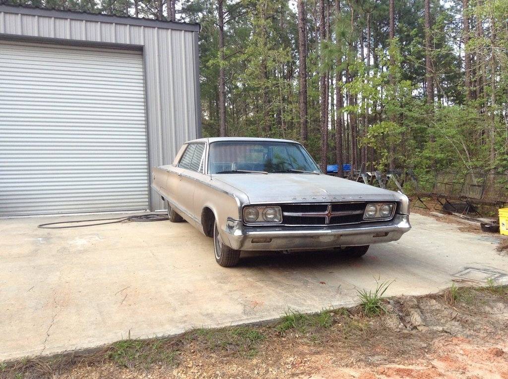

PS. Love the 65. One of my favorite years....
