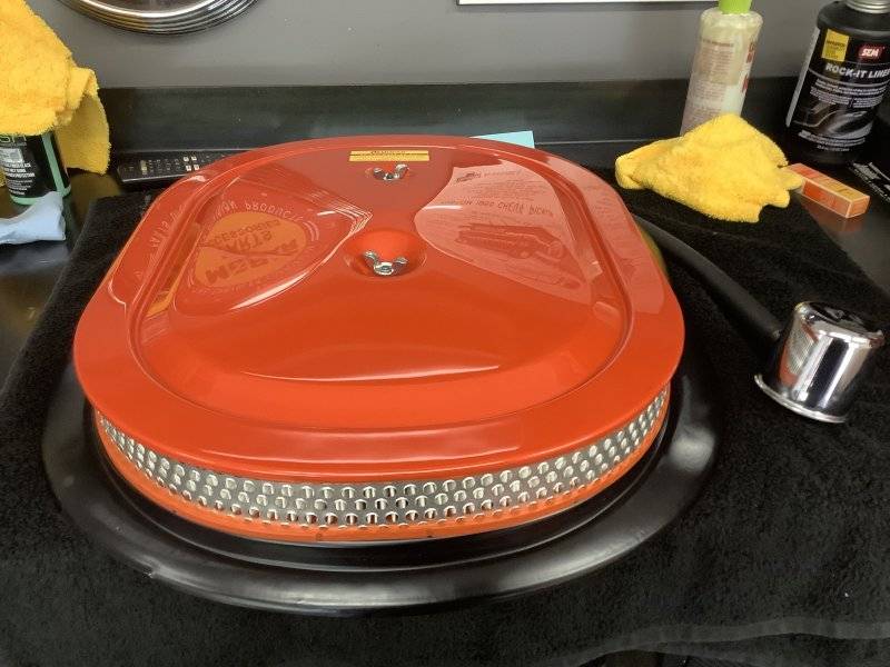

Getting ready to have my 69 Hemi Gtx air cleaner painted and was curious what sheen is the base. Also was there any decals on it that year. I really like the big HEMI decal.
Gloss black on the base
Gloss orange on the lid
Best I remember, the only decal on the lid is the small yellow instructions decal
The Air Grabber lid is a slightly different shade of orange than the engine color, referred to as air cleaner orange. I don’t think the air grabber baseplate is gloss black, maybe 80% gloss. I used semi gloss black on my ‘69.
I think the oversized HEMI decal is a ‘70+ thing…
Damn that looks nice
Is the master cylinder plate at firewall gloss black or semi gloss..
