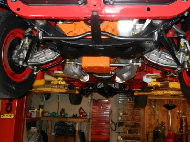

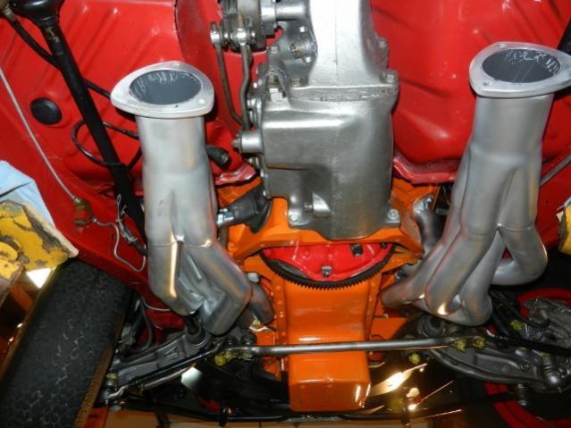

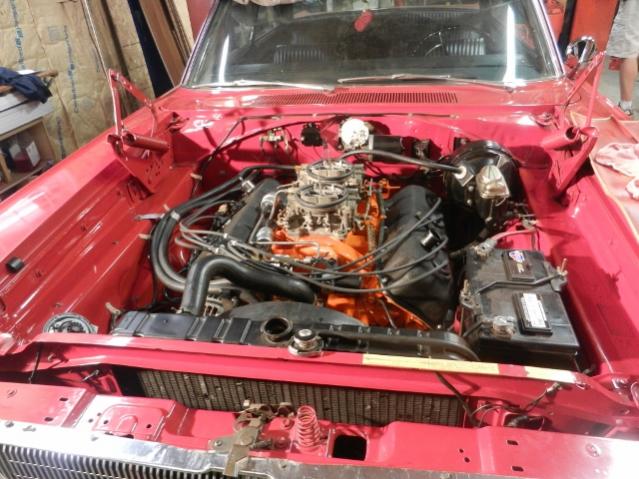

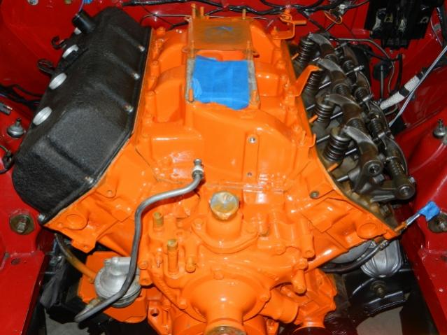

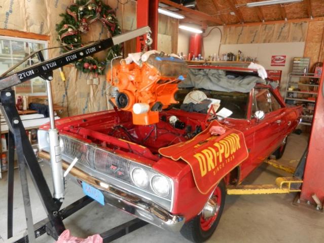

here's a few pic's of the 67 R/T ....
:sunny:Sonny, Tommy & few others have been messing with this beast almost 40 years!!!!
