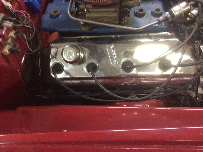

Made pattern off 66 Hemi k frame welded them to a 65 Dodge k frame . This where engine ended up. Headers and x ram dictated position, this before tti. Not best picture, wish was 1.5" forward.
