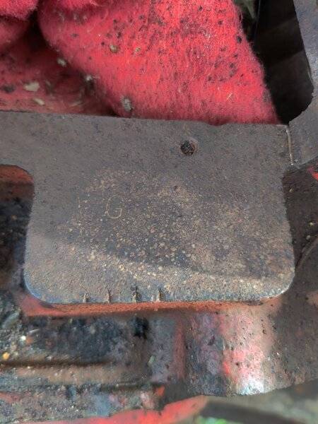

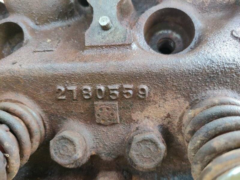

engine side casting # 2468330-1 10-8-66
but the top pad has no numbers at all on it just 2 letters MG
I can see a trace of the original machining marks on the pad so I don't think it's been machined down but why would there not be other marking on the pad?

The original owners' name is Mike Gilbert. If the car was special ordered for racing purposes, Could the MG on the upper pad be his initials the plat put on the engine to designate it going in his car?
Here is a picture of the upper pad before I cleaned it.

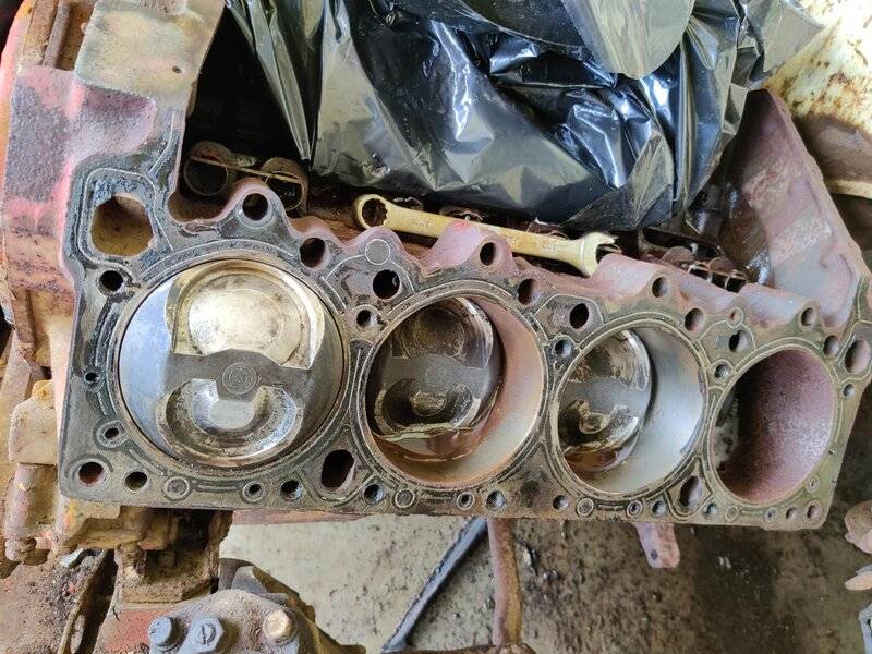

Maybe engine builder or Mike himself stamped it. Those 12.5 pistons didn't come from the factory. Any other cylinders rusted as bad as #7?

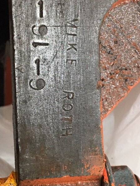

I also have a 66 built 426H and it has a name stamped into the pan rail which I investigate and was told was a drag racer on the east coast some where. I believe this was done so that the block could be ID'd at the machine shop or if stolen. In other words probably not an uncommon practice.
Cylinders # 2,4,& 8 all look about like #7.
I have them soaking in vinegar right now.
It also has roller lifters in the engine. ( Also Not factory )
Appears to have a roller cam. (+ the pistons). Someone built the engine and therefore perhaps stamped the owners initials on it while it was at the machine shop.
You do know that vinegar will ruin aluminum and etch metal don’t you? Know this will take time but it is the end result.
MG. Do you think that’s just an odd coincidence? The factory didn’t know this was going to be MG’s engine when it was built. There is no way that’s a factory marking.
Sorry but 10-8-66 (October of 66) Casting date is to late to belong in a 66 model year car.... 66 production had ended in July 66... 67 model year production started in August of 66..
Very cool car with great history but that's not the original engine.... Really not surprising, race cars were about going quicker & faster, not stampings and date codes.... The only numbers racers worried about is the elapsed time to cover a quarter mile....
Agreed, and the SPD is mar 11 66.
Exactly, and who would be surprised to hear a racer had spares.... or had a better engine built from his dealer supplied warrantee block and ultimately the original engine was lost or destroyed in the process??
BTW, 4 notches in the pad mean 4 rebuilds maybe??
