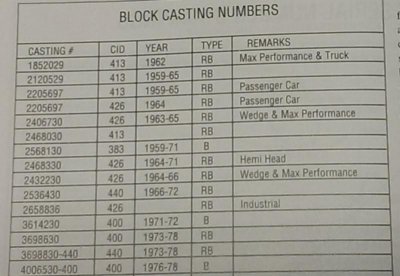

Looks like we need your block casting number...
i've done a search hear on fbbo archives last week and the casting # 1852029 is maxie/ truck that"S all i know.
