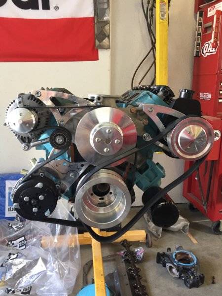

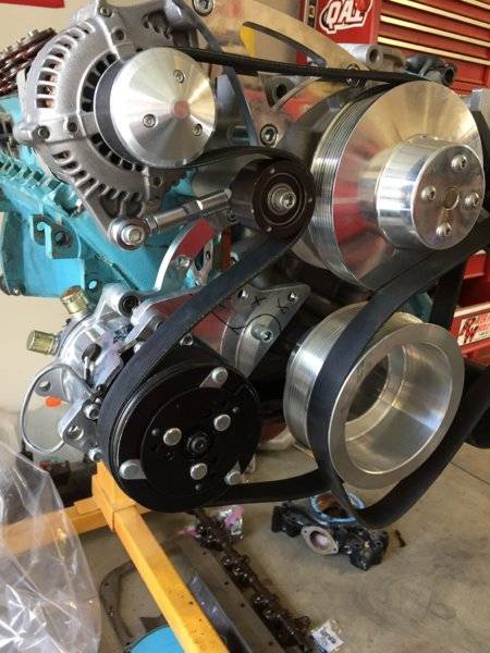

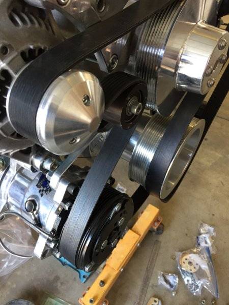

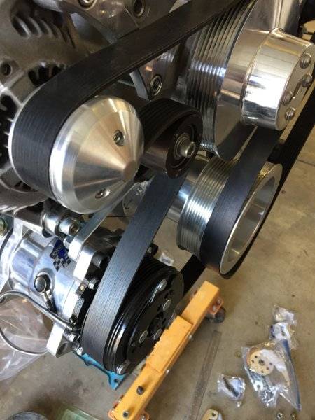

look into an aftermarket A/C that hides the compressor down low...... stock stuff is huge and up top; and hides a beautiful 440

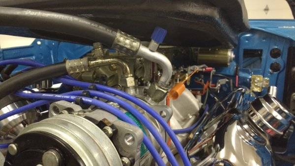

wasn't hood clearance on ram air cars also an issue?
Yes compressor would interfere with air grabber base & A12 bases. Ask me how I know.
