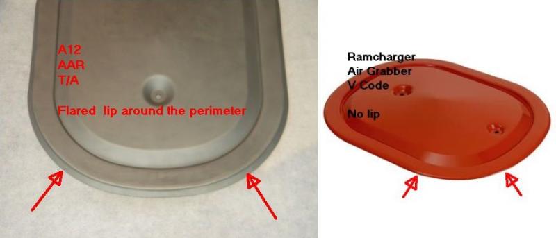

The shield in front is for non air grabber hood.
440-6 is correct. The front baffle is for non fresh air cars only. No need to baffle the front on air grabber cars because the fresh air hood seals on the base and isolates the element anyway.
And the air grabber has wide lip lid.
I stand corrected,here is the application.
