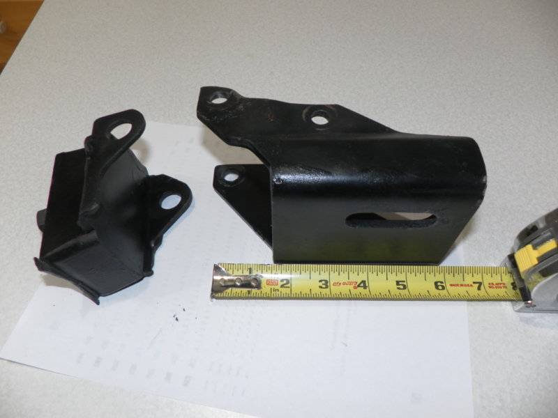

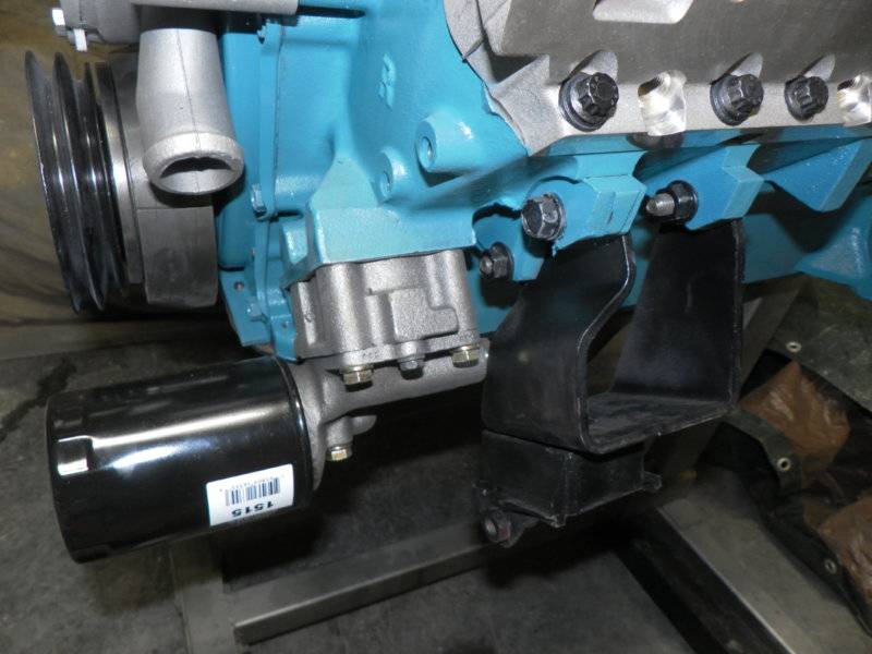

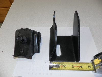

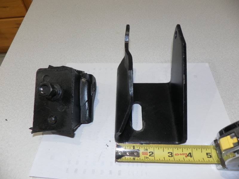

started to put engine on k frame and engine mounts are about 6" wider than k-frame mount holes. '67 charger had 318 in it and 440 is from motor home. mounts look like what I see on internet. this is what I had on right side in 1st 2 pics. 3rd pic. is what is on left side.
Are those the mounting brackets that came with the motor home engine? You need mounting brackets for a 1967 Charger. Schumacher is out of stock on his brackets but you might find some used ones somewhere or perhaps there is someone else who reproduces them. The isolator pads are easy to find, it is the steel brackets that can be a little tougher to round up.
yes, I just got them from 440 source and also being motor home had air , I also had to get alternator and power steering brackets.
