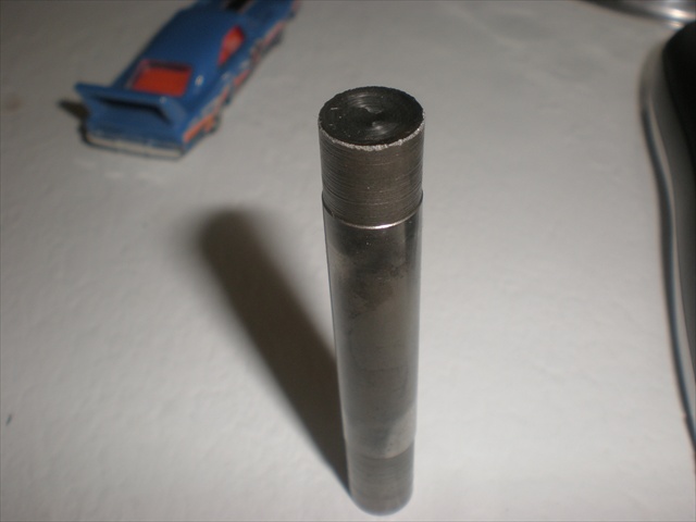

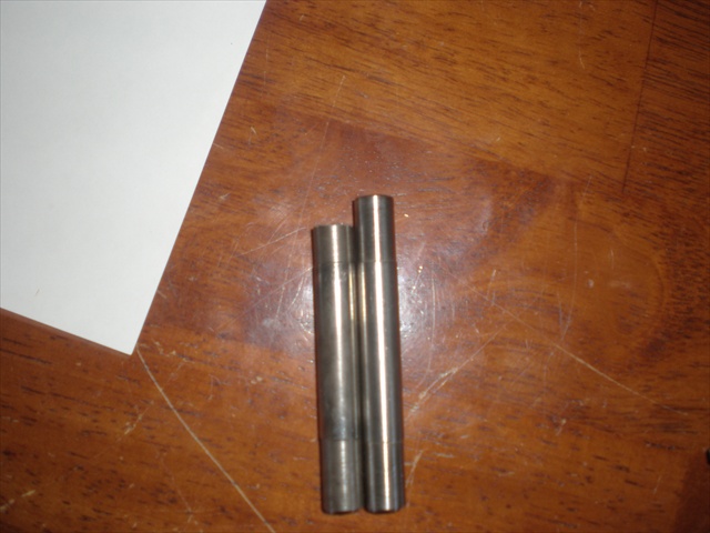

be very carefull I ruined a crank and motor with a mopar performance rod that was not hardened correctly
spend the money and buy a good hardened one from hughes engines

If it's made in China, you might want to wait for an original to show up. I've heard of some having wear issues with the local parts house China made junk....
i agree, there was a real bad batch of mopar performance ones made years ago and the metal was so bad, the pushrod had a nice mushroom cup to it and my car wouldnt run.i couldnt believe how bad it wore out. like under 500 miles too. get a good one and dont cheap out.
cupped
