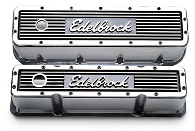

Does anyone know of a BB valvecover with removable top for setting rockers? Anyone own some, do you like them?
Search the forums for this - I know someone posted about this some time ago.
We used an old valve cover and cut the top of with a torch or grinder and bolted it on. Worked great.
I'm looking for a set to leave on the car. The set I found on the search was a homemade set.
Not sure if they make them for a 440.

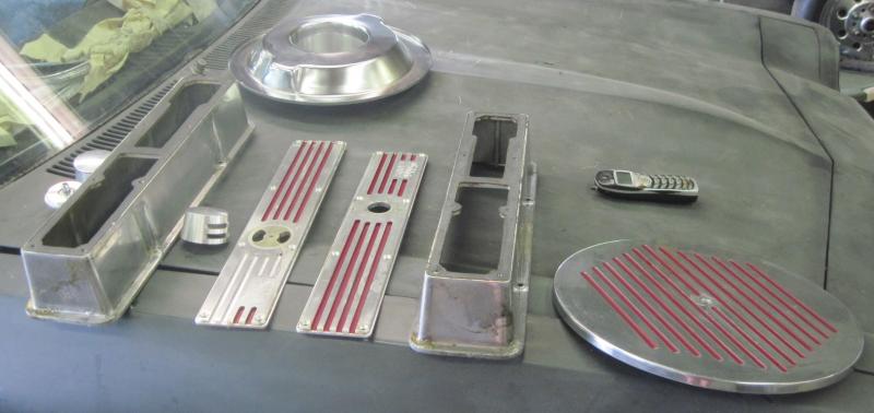

The only ones I've seen and/or restored personally are for GMs but they sure are cool!
Billy scored this entire SBC Lil John Butera setup on ebay for $18. Yep, eighteen dollars. He can't decide what he wants me to do with them yet.

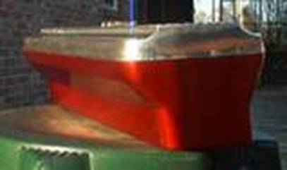

You might have good luck with the Mickeys versus say some old Cal Customs; the ribs on M/Ts, similar Holleys and older Edelbrocks end at the top of the short end while those on Mopar Performance creep over the edge 1/2" to 5/8" (depending on which rib) and the Cal Customs extend all the way to the gasket rail. If you hit the lottery you can try to find some Jensens ... they'll bolt right up (they came with 440s) and are so thick you'll have tons of material to work with. I've restored probably a few hundred pairs of valve covers over the years so if you need pictures of particular styles for your mock up ideas just let me know. I'd love to see ya make this work. :D
