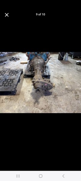

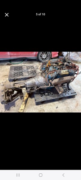

Is this a weird concoction? A BB trans hooked to a small block adapter??
From what I understand BBs were only hooked to NP 203
Yes that is correct.
I can't quite tell from that picture though what you have there
They started in 88 in the trucks. What engine is it ?
This is a 440 with with a 241. Sorry the pics are from an ad.
Ok I think I get the gist, it's a certain sized tailshaft from a smallblock put into the BB 727. Then you can use that adapter.
