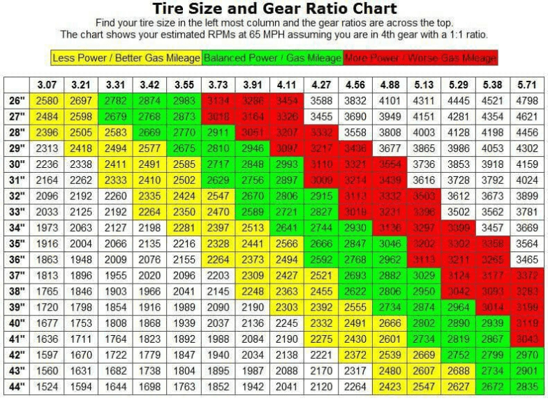

Ridiculous. Your 318 will be in pieces before the weekend. Here's a chart. With a 28" tire (common size) your 318 will be screaming at 4200 rpm at 65 mph.

I do agree with the guys you will tire of them quite quickly with the engine revin' 4800 rpm at 40 mph.
A stock 318 is pretty much done at 4500 rpm

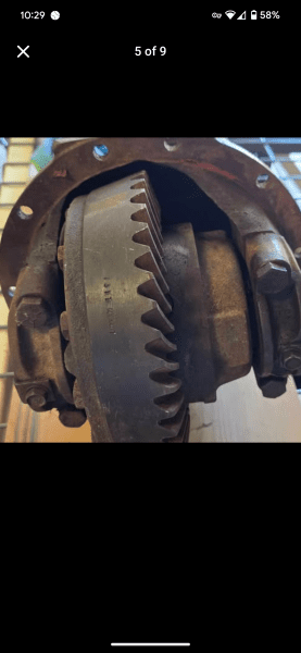

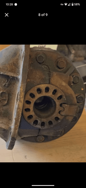

No. Plus, it looks a lot rust crusty. 5:37 gear ratio? Haven't heard that number before, 5:38? It's still not worth the time and money.
