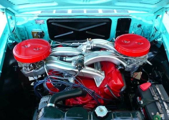

as for the intake I said I'd talk about later this is the inspiration for it
The plan is individual runners that bolt to the engine for easy removal, and some aluminum boxes to bolt the throttle bodies to that will be linkage driven and likely an older magnum throttle body style.

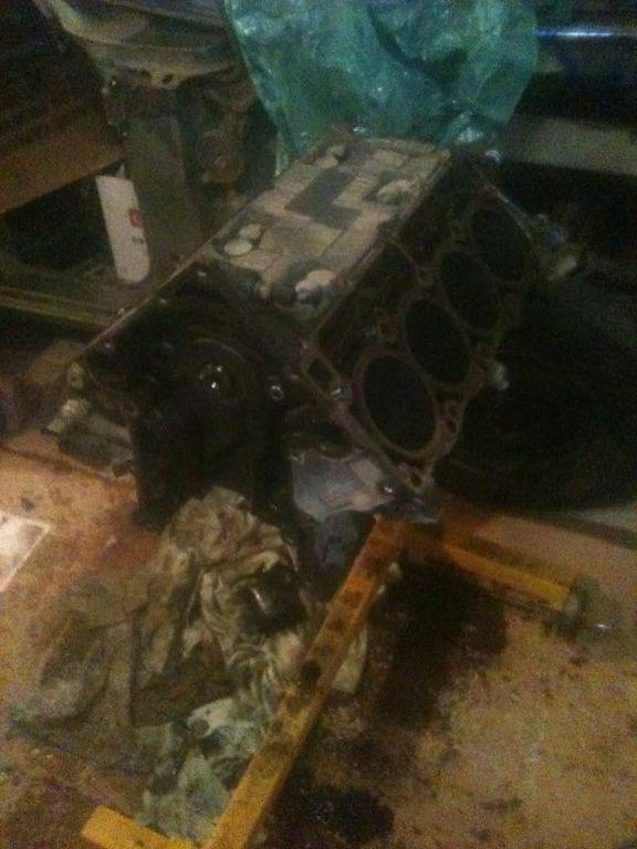

stripped down 5.7 hemi block:

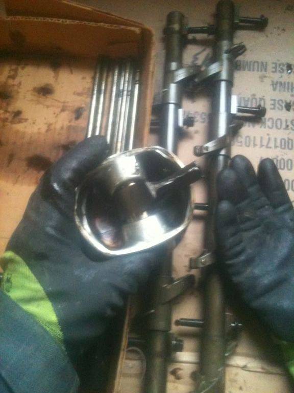

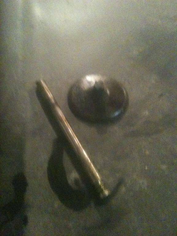

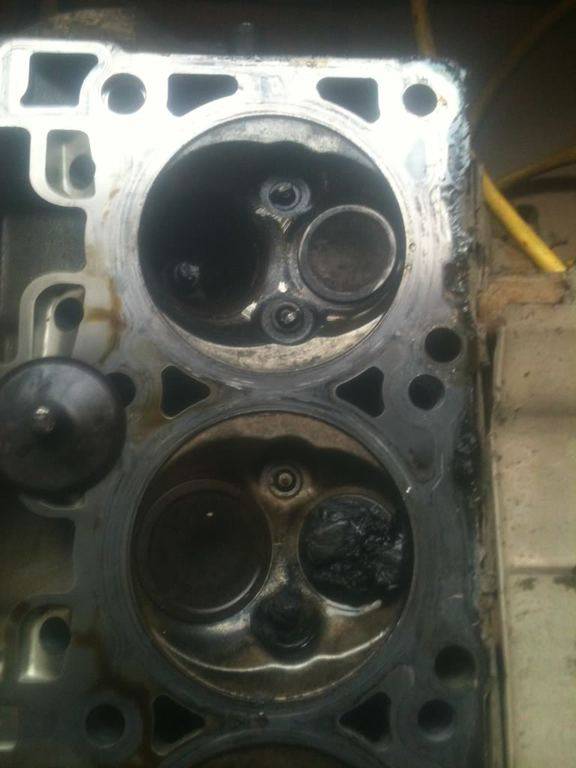

one busted valve:

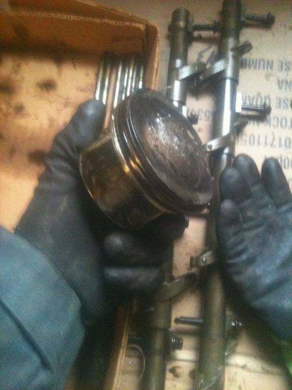

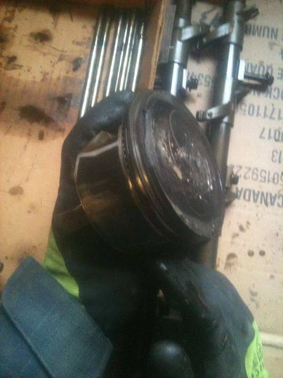

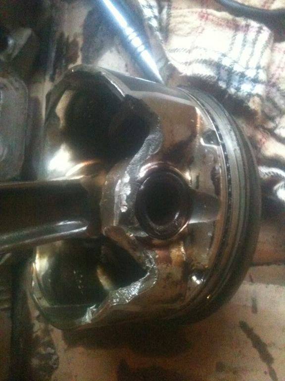

cylinder number 1 has the busted valve number 3 had a big chunk of plastic melted to the exhaust valve
number 1 piston damage:
number 2 piston damage:
I have a 2010 engine block. I might try and swap the crank rod and pistons into the 08 block. since the 2010 block has less then 10thousand Km on it.
The 2010 short block has VVT and a different crank tooth count and sensor. The rods out of the 2010 will work in the 08 with the 2010 pistons given you will be using the 2009 and up Eagle style of heads. The 2010 crank in the 08 block is a bad idea depending on what you are going to use for an ecm.
