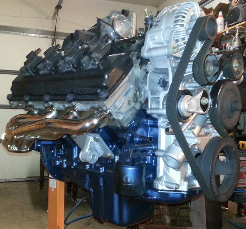

I just took my aluminum ones and cleaned them then put on VHT Wrinkle Plus paint. Make sure you follow the instructions and bake them to tighten up the wrinkle. Looks pretty good.
