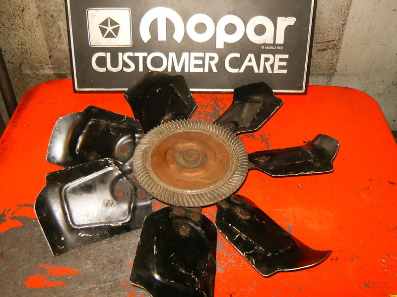

Might be true compared to a flex fan, but an aluminum fixed blade fan will move as much air as its steel counterpart, and have much less wear on water pump bearings doing it. Like this one. See how the blades turn on the end? Not all of them are like that. That's the extra heavy duty cooling fan. They move some air.
Rusty - that is a monster - The 7 blade I have does not curve like that one, the blades are smaller and thiner. I will take a shoot of the two this weekend and post. Drove the 5 blade last night, no shroud and too close to the radiator - 205 all day long, think a shroud would bring it down a bit
It is a monster and it'll do the job. It's also a light monster, since the blades are aluminum. Far as I'm concerned, it's the fan to have.

Rusty, can you please PM me a part # and source for that 7-blade curved and staggered viscous fan? Thanks much for any and all help..
