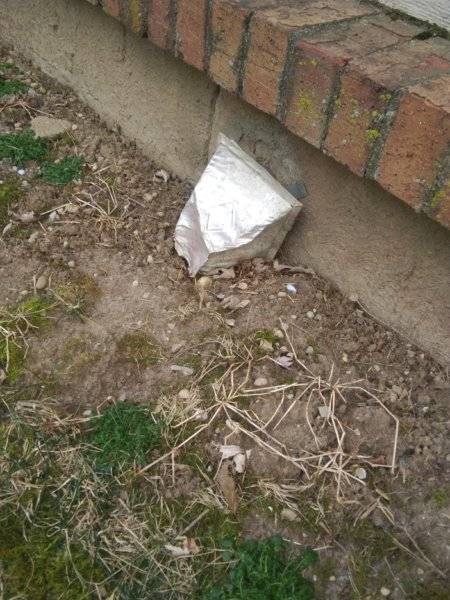

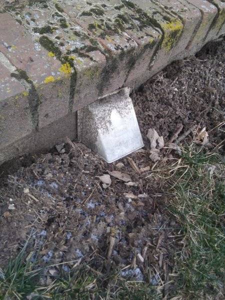

Look what i found today. Can you say, fire waiting to happen ?
