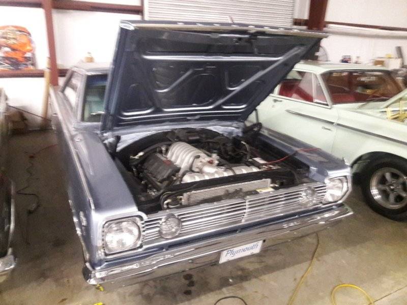

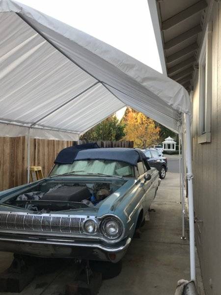

Hey everyone. Love this site. Always great input and I love stopping in just to see what everyone has going on. I’d love to say I’m going to consistently update my build, but I work full time, married, and have a 2 and half year old. But I still do make tome to work on the car.
Original black plate Bakersfield car. Shows 82K on the odometer. Supposedly the car got stored for 2 long stints of time... once in a barn, and then 2nd owner’s garage where I bought the car.

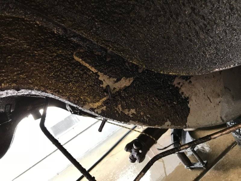

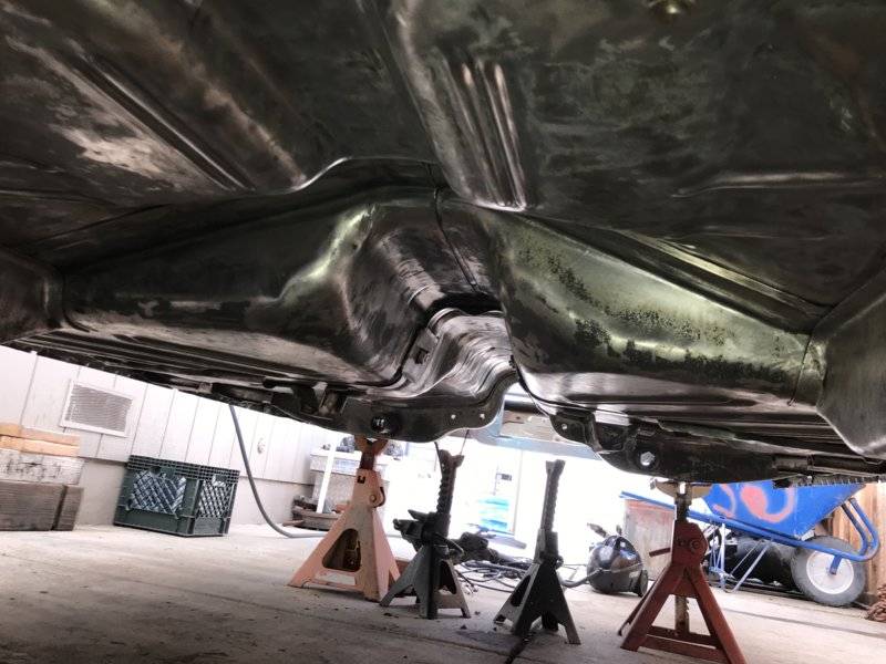

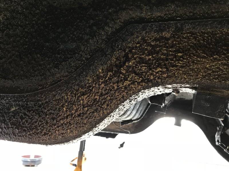

October will be one year since I’ve had it. I’ve pretty much been stripping the underside since I got it. Front and rear suspension are gone now and the 1/2”-3/4”of undercoating is now down to bare metal/primer.
Plans are resto mod style while keeping the classic touches such as the exterior trim and most of the interior.

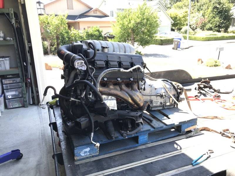

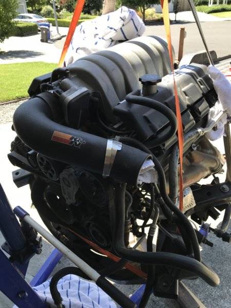

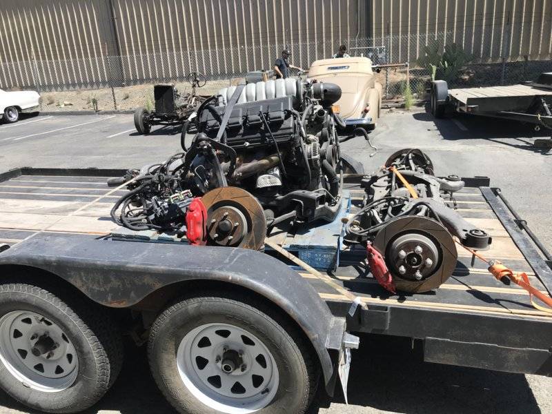

First big spend is in the books! Found a 6.1 SRT8 motor and transmission with all of the computers and only 40K miles which is low considering those motors are 10 years old. Hotwire harness in my near future.
Stay tuned for updates if you’re interested!!! 9E052EF6-65F9-4420-BAFF-608BABB57354.jpeg 4217C213-EFD3-4D29-A8B3-DD4B02A21EE6.jpeg 1988D8F0-0B5D-479E-B294-E13EDE47A1A0.jpeg 94B1E73D-38D2-47C9-B47E-C37EF1E11420.jpeg 8CEFA502-78C2-4400-8C0C-DDE22F6704B7.jpeg

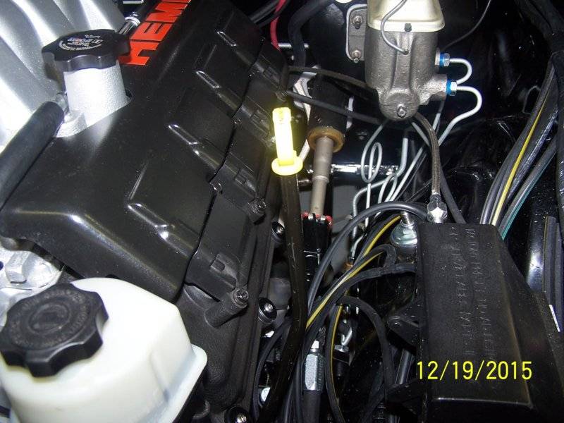

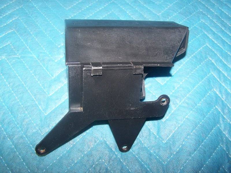

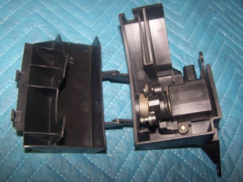

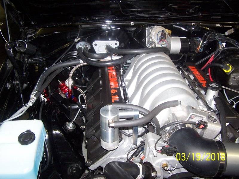

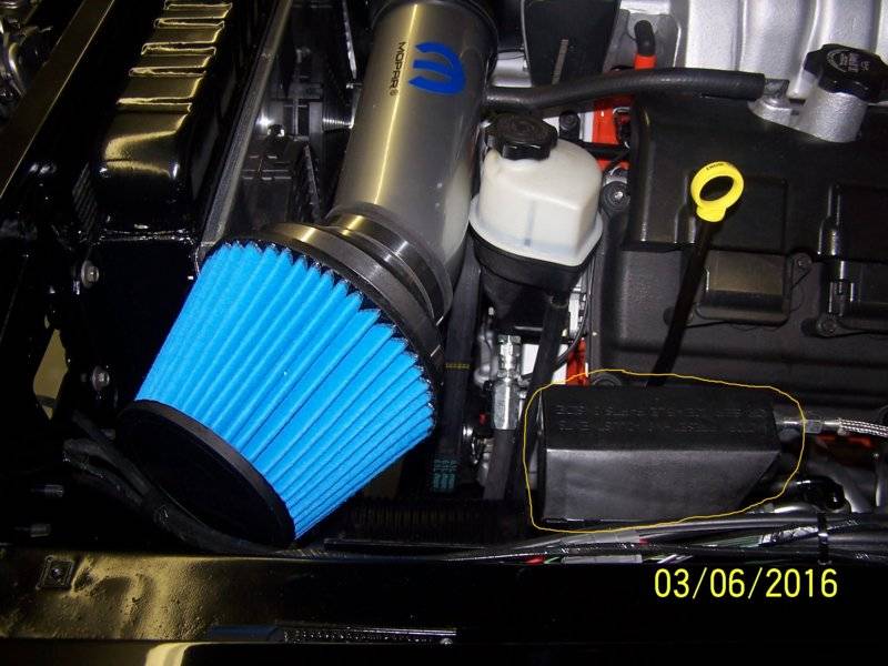

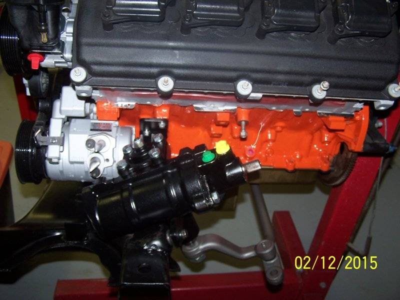

I too wanted to keep my factory gas pedal. I used 5.7 hemi's method to make it happen. It is a Throttle bell crank from a 2003-4 Hemi Ram. PN: 53032456AE. I bought mine new from a local Dodge dealer. They are pretty expensive at over $350.00. You should be able to find a used one at a salvage yard. I have a spare that I bought for $60.00. I mounted mine under the hood near where the battery tray used to be and used an aftermarket cable between the gas pedal and bell crank. If you go this route, you will need to relay that info to Hotwire when they build the harness since the drive by wire plug needs to go into the engine bay instead of under the dash. Here are a couple pics.

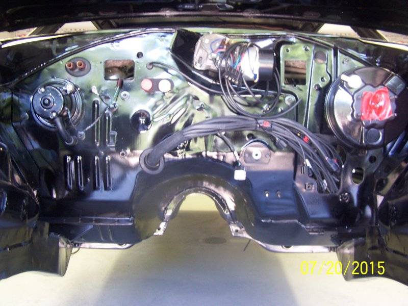

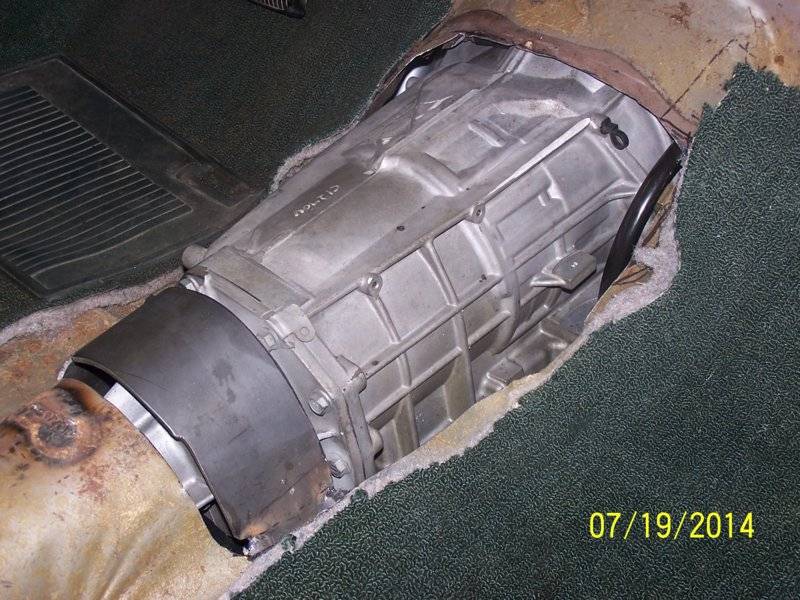

I have lots of pics the install in my 68 Charger . Yours will be quite different though with using the Nag1 transmission. There has been tons of headway made since I did mine and I used the 5R45RFE truck transmission because of the isssues with controlling the Nag1 had not been ironed out yet. I am sure glad Mopars have the removable K frame making it a snap fitting these drive trains in. I think I had mine in and out half a dozen times before I was able to button it up for the last time. I had to make more cuts to the tunnel since the truck transmission is larger than the Nag1. Here are some pics that may help you. I bought a kit from Bouchillon Performance when I did mine. They had me install a Corvette fuel regulator between the in tank pump and engine and a lot of other trial and error issues that hopefully they have ironed out by now. I had plenty of problems with it and finally replaced it with an adjustable regulator. Some people have made it work I guess but IMO it is junk science. Chris at Hotwire is up to speed on these swaps and is very helpful with technical questions. Good luck with your install. I'm sure you will love it when it's done. Way better driveability, fuel mileage and a host of improvements to enjoy. If I can help, don't hesitate to ask. We are all here for ya.

You should be able to find one. I believe the 03 and 04 Hemi Rams used them. If you can't find one, let me know. I would sell the one I have in post #10

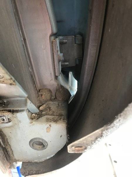

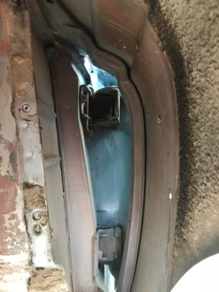

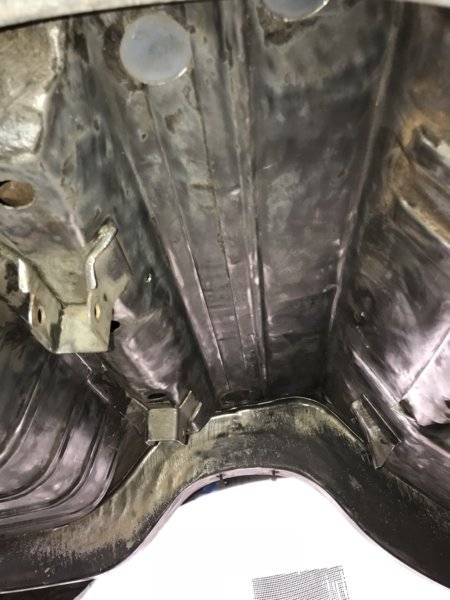

Just an update. Before that 6.1 goes in, the underside of the car is getting primed and coated/painted. Since my antenna was loose, I decide to pull the access panels in the rear of the front fender wells to take a look at the lower rear of the fenders where muck likes to hide and start rust. I was overly happy to see how clean and virgin the inside of the fenders were. Pictures barely do it justice. Not even wiped down or air blown before these pics!
